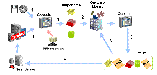

For both software and server provisioning the user needs to perform a one-time activity of setting up a Software Library. For server provisioning additional elements like Boot server, Stage server, and RPM repository have to be configured as required by the provisioning application. Once configured, the same elements will be used for any software or server-provisioning operation performed using the provisioning application.
Once the environment is ready, the user can use the Enterprise Manager user interface to create components, directives, or images for deploying them onto the target servers. This is explained in Figure 13-2.
Figure 13-2 Creating Software Components Using Enterprise Manager User Interface
You can use either tested reference installations or installation media to create software components from the Enterprise Manager User Interface. The RPM repository is used for creating the out-of-box operating system components that one needs to provision on the bare metal or live servers. You can use the Enterprise Manager User Interface to create Directives and other server provisioning constructs like Storage templates, Hardware templates, and Network templates.
The reusable entities created above are stored in the Software Library.
These reusable entities can then be used by deployment procedures for deployment or mixed and matched to create deployable images for the hardware servers, which are again stored in the software library.
The images or components can then be deployed on test or production environments.
