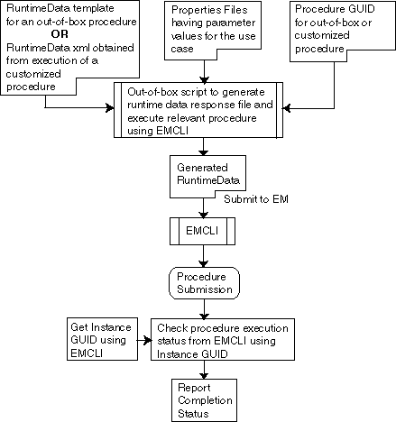

  4. Automatable
    The runtime for all the deployment procedures can be automated using EMCLI and associated verbs, such as Oracle patching, OS patching and so forth. For more information on these verbs, see the Oracle® Enterprise Manager Command Line Interface 10g Release 3 (10.2.0.3) for Windows or UNIX.

10.8 Using EMCLI to Execute Deployment Procedures
Oracle provides out-of-the-box templates for creating run time data for deployment procedures used in the most common use cases. These are known as runtimedata templates. You can access them under the emcli/samples directory in the OMS oracle home and you can then modify the configuration properties in these templates.
The process to use EMCLI to execute deployment procedures is depicted in Figure 10-1.
Figure 10-1 EMCLI Process to Execute Deployment Procedures
Description of Figure 10-1 follows
Description of "Figure 10-1 EMCLI Process to Execute Deployment Procedures"
There are four required actions to execute deployment procedures. Those steps are described below:
  1. Step 1: Find the GUID of the procedure to be executed using EMCLI. This is a one-time activity.
  2. Step 2: Obtain the RuntimeData xml or RuntimeData template for the procedure that needs to be executed. This is also a one-time activity.
  3. Step 3: Create the properties file for the RuntimeData xml or RuntimeData template. This step is required for each execution of the procedure.
  4. Step 4: Submit the RuntimeData template or RuntimeData, properties file for the given execution and procedure GUID as input to an out-of-box script that will generate a new runtime data response file and then use this response file to execute the procedure using EMCLI.
Each of these steps is discussed in detail in the subsequent sections.

10.8.4 Step 4: Procedure Execution
First download and apply the Metalink patch - 5890474 on OMS 10.2.0.3 which will update the EMCLI procedure execution scripts, out-of-box templates, and properties files. This updates the emcli/samples and emcli/scripts directory in OMS oracle home. After applying the patch on the OMS, download the procedure execution scripts, out-of-box templates, and properties files on the machine where the EMCLI client is set up. The out-of-box templates and properties files for patching and provisioning are available in the respective directories under OMSHOME/emcli/samples/.
Once the RuntimeData template or RuntimeData xml and properties file are ready then the procedure can be executed using the following script.
Usage:
perl executeDP.pl -t <template> -p <properties file name> -g <DP GUID> [-s <schedule> in the format yyyy/MM/dd HH:mm] [-z <time zone ID>] [-d <emcli directory path>, mandatory if emcli executable is not in the current directory]
Template -- The name of the RuntimeData template for out-of-box procedures or location of the RuntimeData xml file downloaded after the execution of a customized procedure.
Properties file name -- The location of the properties file created for executing the procedure.
DP GUID -- The GUID of the procedure that needs to be executed.
emcli Directory -- The directory which contains the EMCLI executable. If the current working directory contains the EMCLI executable, this parameter is optional.
Schedule -- The time when the deployment procedure would be scheduled to run. If not specified it defaults to running the deployment procedure immediately. The HH:MM is based on 24 hrs clock, for example, 22:30.
Time Zone ID -- The time zone to which the deployment procedure run is scheduled. If not specified it defaults to the time zone of the OMS.
Below is a sample code string executing RAC provisioning procedure for UNIX using out-of-box procedure:
perl executeDP.pl -t crsasmrac_gold_prov_template.xml -p Properties.txt -g 1F8178444594E67CE040578C8A0309BA -t 2007/02/03 10:00 -z Americas/New_York -d /oracle/prod/orahome/
The following parameter descriptions apply to the script:
crsasmrac_gold_prov_template.xml is the name of the out-of-box template.
Properties.txt is the properties file
1F8178444594E67CE040578C8A0309BA is the GUID for the RAC provisioning procedure for UNIX
2007/02/03 10:00 is the date and time during which the Deployment Procedure is scheduled to run.
Americas/New_York is the Time Zone ID for which the time schedule is set.
/oracle/prod/orahome/ is the directory location for the EMCLI executables.
The properties file and the out-of-box template are located in the same directory as the executed script.
