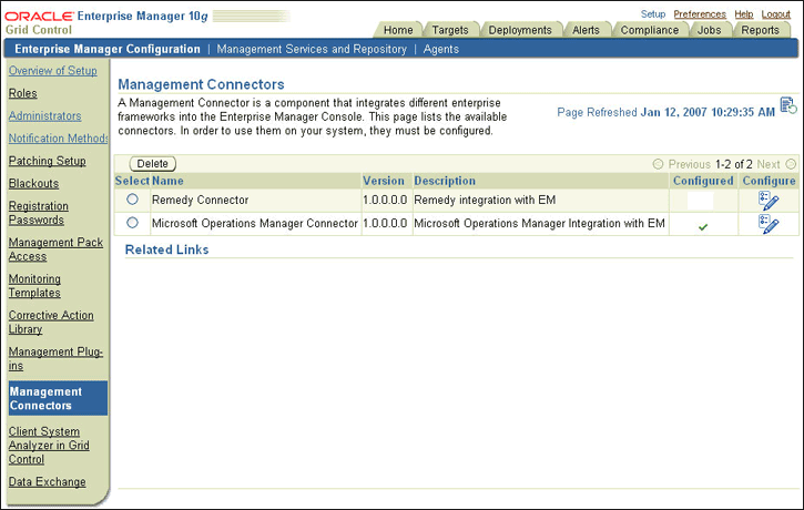

As Super Administrator, from the Enterprise Manager console, click Setup.
Overview of Setup page appears.
Click Management Connectors in the left pane.
The Management Connector Setup page appears. For the Remedy Connector row, the Configured column should be blank (Figure 16-1).
A check mark instead indicates that the Connector is already configured.Click the Configure icon for the Remedy Connector.
The General tab of the Configure Management Connector page appears (Figure 16-2).
Provide the required settings. See "General Settings" for details.
Click OK.
The Management Connectors Home page reappears. The row for the Remedy Connector should have a check mark in the Configured column.

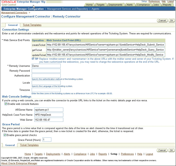

The following sections explain how to provide various configuration details.
The Remedy Trouble Ticket connector communicates with the Help Desk through their Web services. Mandatory fields are indicated by a * mark.
*Web Service Endpoints — Endpoints to createTicket, updateTicket, and getTicket Web services exposed by Remedy Help Desk. See "Web Service Details" for additional details.
*Remedy Username— User with the privilege to create, update, and query tickets in Remedy.
Remedy Password— Password associated with the supplied Remedy user.
Authentication— String that a Remedy administrator sets for additional security. Applies only if the Remedy Administrator has configured it on the Remedy AR server. It communicates with the server if there is a secondary authentication server that can be used to verify the Remedy credentials.
Locale— Language of the Remedy system (optional).
Time Zone— Time zone of the Remedy AR System Server (optional).
See Also:
Section "Remedy User preferences settings" in the Remedy Remedy AR System Server product manual Remedy Action Request System 6.3 - Developing AR System Applications: AdvancedWeb Console settings are required if the users wants the Connector to provide links to Remedy Help Desk tickets created by Enterprise Manager in context of an alert.
To enable this functionality, provide the following Web console settings.
Enable web console — Check this box to enable launching of Remedy ticket page within context from Enterprise Manager.
ARServer Name— The Remedy AR Server name.
HelpDesk Case Form Name—The Remedy form name that the Remedy Web Services (you configured the connector to use) is based on. The Remedy default Help Desk webservices, for example, use the form HPD:HelpDesk.
Web Server — The name or IP address of the server that hosts Remedy Mid-Tier.
You can enable and disable the grace period and configure its value. By default, the grace period is disabled. See "Grace Period" for details.
This setting applies to all alerts processed by Remedy Connector.

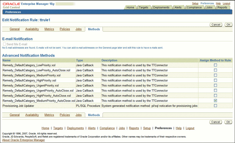

Create a notification rule using the following steps:
Important:
Do not select more than one ticket template for this notification rule.From the Enterprise Manager console, click Preferences.
In the left pane, under Notification, click Rules, then Create.
In the Create Notification Rule General page, specify the rule name, description and the targets for which this rule should apply.
In the Create Notification Rule Availability page select the availability states for which you want to create tickets.
In the Create Notification Rule Metrics page, select the metrics and their associated alert severities for which you want to create and update tickets.
Ensure that you select all relevant alert severities if you want the ticket to be updated when the alert severity changes. For example, to open a ticket for critical alert on CPU Utilization(%) metric, and the ticket to be updated if the CPU Utilization(%) changes to warning or clear severity, then in the notification rule, select Critical, Warning, or Clear severities for the CPU Utilization(%) metric.
In Create Notification Rule Methods page, choose the ticket template from the Advanced Notification Methods table (Table 16-1).
In the table, registered ticket templates appear as Java Callback type notification methods under the same name as the ticket template's file name. This ticket template will be used to open tickets for all availability and metric alerts specified in this notification rule.
This makes the ticket templates available for use to open tickets.

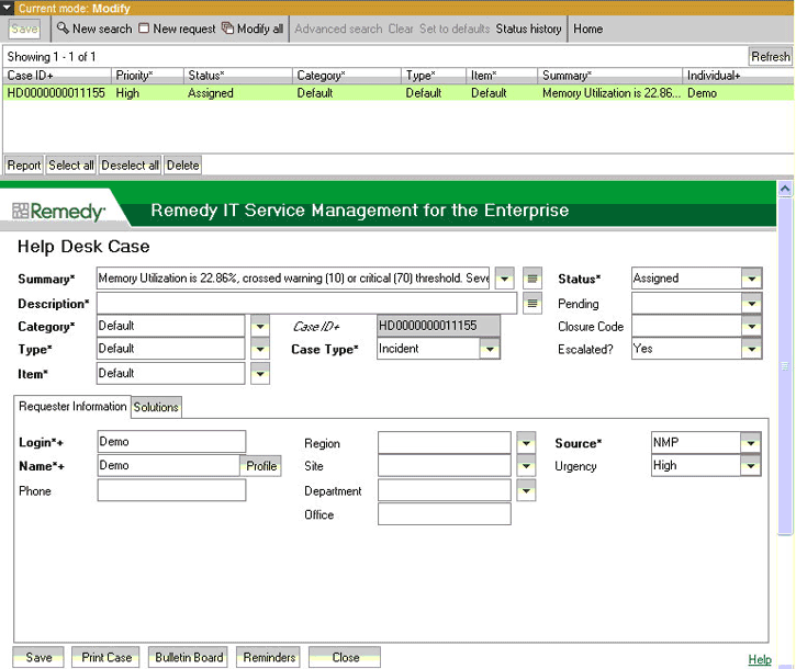

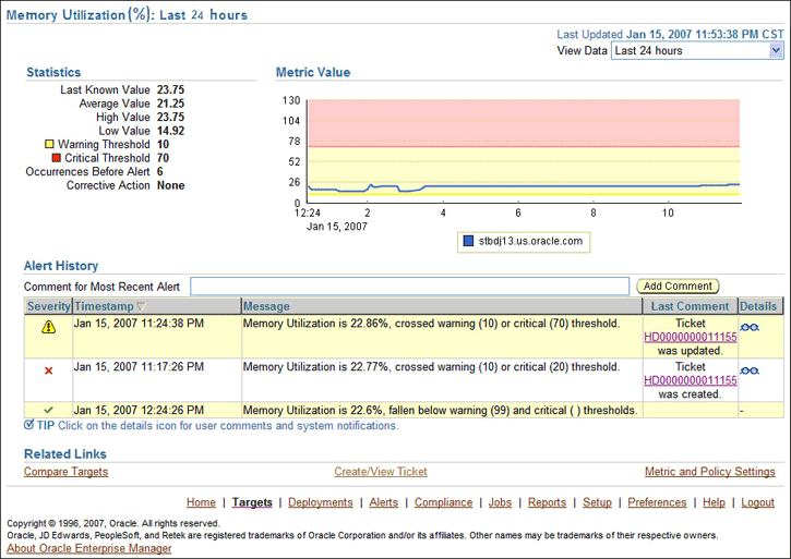

Chapter 13, "Configuring Notifications"The following process occurs after you create the notification rule for your alerts:

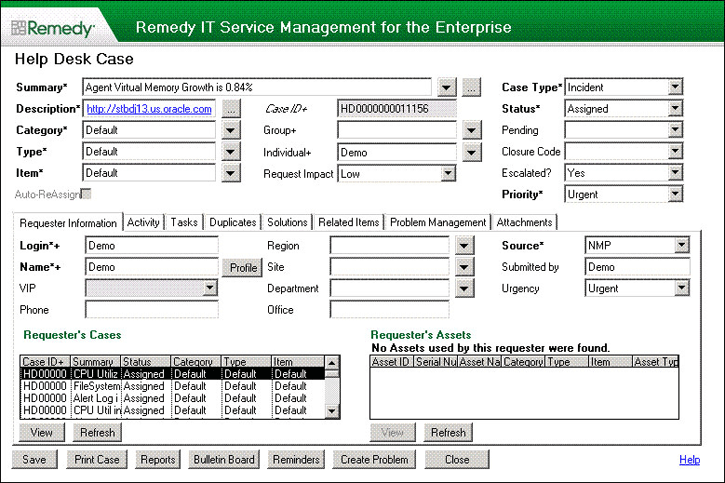

A notification is sent to the Remedy Connector when a metric alert that matches your rule triggers. The Remedy connector creates/updates a ticket according to the ticket template as set in the notification rule.
The ticket is created or updated on the Remedy Trouble Ticket system.
In Enterprise Manager, the alert annotation is updated. A comment is added to the Metric Details page of the alert to indicate that a ticket was created or updated, along with the ticket ID and ticket page URL.
A ticket is updated if there is an existing active ticket for an alert. In Figure 16-4, the first screen shows the ticket in Remedy console and the second screen, the alert as displayed in Enterprise Manager.

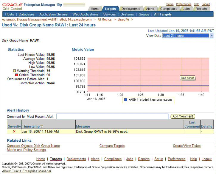

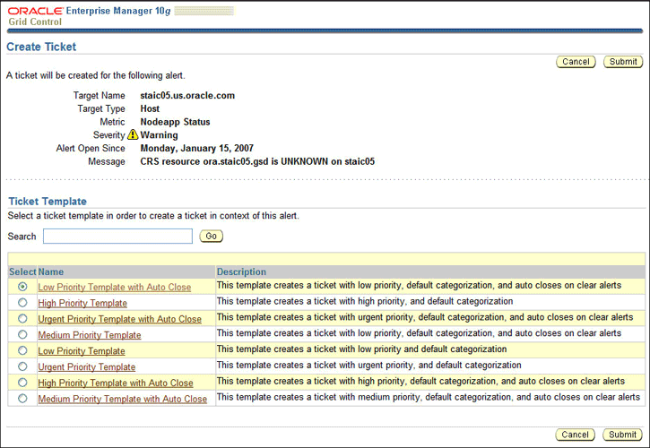

Perform the following steps to create a ticket manually:
After a metric alert occurs, go to the associated metric details page for the alert. To access this page, click the alert message in the Enterprise Manager console (Figure 16-5).
Click the Create/View Ticket link in the Related Links section.
The Create Ticket page appears if no active ticket exists for the alert.
Select a ticket template and then click Submit (Figure 16-6).
If you do not see the desired template, then you can register one using the emctl. "Registering Templates"
If creating or updating the ticket is successful, the ticket ID appears in the Last Comment column of the Alert History table for the metric alert.If the Web console settings are configured and enabled, the ticket ID appears as a link to the ticket page in the Remedy Help Desk. If there is no annotation, then the ticket creation fails and error information is logged in the file emoms.log.

From a ticket page, click the link in the Description field to the Alert Details page in the ticket message body (Figure 16-7). This takes you to the Enterprise Manager console login page. After you provide Enterprise Manager username and password, you will be forwarded to the alert related to this ticket.
View privileges on the target on which the alert was raised.On the Remedy console, if the URL appears as text, then you will need to cut and paste the URL into the browser.
In the Enterprise Manager console, click the alert message to go to the metric details page for the alert.
In the Alert History table, locate the ticket ID link in the Last Comment column.
(If not found) Click the icon in the Details column to get more information about the alert.
On the page that comes up, locate the ticket ID in the Alert Details table.
Click the ticket ID link. You are forwarded to the Remedy Web console login page.
Provide valid Remedy account details.
The ticket page associated with that alert is displayed.

Set the Remedy ticket summary based on the alert message. On update, the ticket summary field is updated to include the latest alert message information.
Set the Category, Item, and Type fields in Remedy to default.
Set the Priority (ticket's priority) to the value indicated by the file name of the ticket template. For instance, Remedy_DefaultCategory_HighPriority.xsl sets the ticket priority to High.
Following are the out-of-box templates:
Remedy_DefaultCategory_LowPriority.xsl
Remedy_DefaultCategory_MediumPriority.xsl
Remedy_DefaultCategory_UrgentPriority.xsl
Following are the out-of-box templates with the AutoClose suffixed to the file names. They set the ticket status to Close when the event severity value becomes Clear.
Remedy_DefaultCategory_LowPriority_AutoClose.xsl
Remedy_DefaultCategory_MediumPriority_AutoClose.xsl
Remedy_DefaultCategory_HighPriority_AutoClose.xsl
Remedy_DefaultCategory_UrgentPriority_AutoClose.xsl
Following are the out-of-box templates with Wlog suffixed to the file names. They are customized for the Web services with worklog enabled.
On update, the Description (Remedy ticket description) is updated with the latest event information and the work log is updated with the latest severity and timestamp information.
Remedy_DefaultCategory_LowPriority_w_Wlog.xsl
Remedy_DefaultCategory_MediumPriority_w_Wlog.xsl
Remedy_DefaultCategory_HighPriority_w_Wlog.xsl
Remedy_DefaultCategory_UrgentPriority_w_Wlog.xsl
Remedy_DefaultCategory_LowPriority_AutoClose_w_Wlog.xsl
Remedy_DefaultCategory_MediumPriority_AutoClose_w_Wlog.xsl
Remedy_DefaultCategory_HighPriority_AutoClose_w_Wlog.xsl
Remedy_DefaultCategory_UrgentPriority_AutoClose_w_Wlog.xsl
