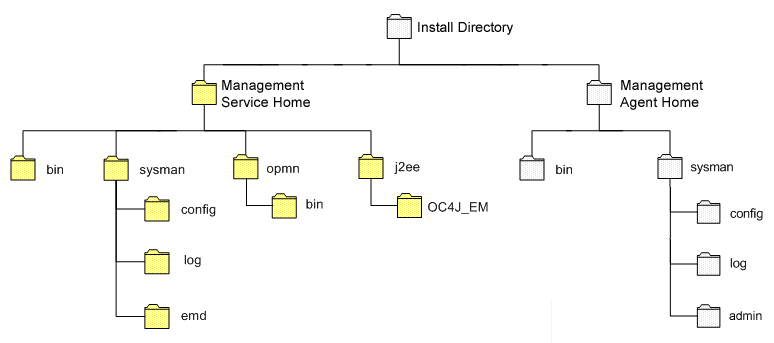

Figure 1-1 shows some of the important directories you should be familiar with in a typical Grid Control Console installation. You can use this information as you begin to maintain, troubleshoot, and configure the Oracle Management Service installation.
Figure 1-1 Important Oracle Management Service Installation Directories
Table 1-1 describes in more detail the Management Service directories shown in Figure 1-1. In the table, ORACLE_HOME refers to the Management Service home directory in which the Oracle Management Service is installed and deployed.
Table 1-1 Important Directories in the Management Service Oracle Home

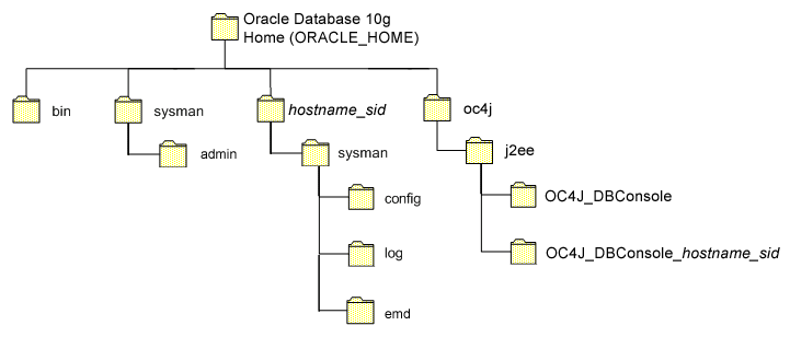

Figure 1-2 summarizes the location of the important Enterprise Manager directories in a typical Oracle Database 10g home directory. Note that references to hostname_sid are for single instance databases; cluster databases have paths of the form nodename_sid instead.
Figure 1-2 Important Enterprise Manager Directories in an Oracle Database 10g Installation

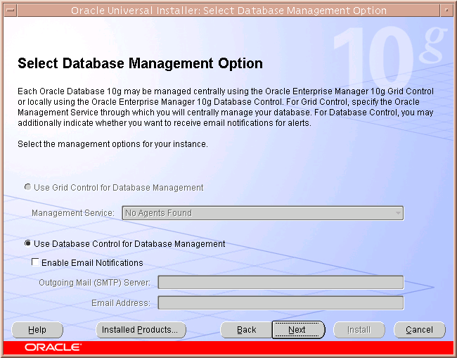

If you create a database while installing Oracle Database 10g, you have the option of configuring your database so it can be managed by Oracle Enterprise Manager 10g Grid Control Console or by Oracle Enterprise Manager 10g Database Control Console.
Figure 1-3 shows the Management Options page, which allows you to select your database management options while installing Oracle Database 10g.
Figure 1-3 Selecting Your Management Options While Installing Oracle Database 10g
To select Grid Control Console as your management option, the Oracle Management Service must be installed on a network host. In addition, the Oracle Management Agent must be installed on the host where you are installing the database. Otherwise, the Grid Control Console option is unavailable and you must instead choose to manage your database with Database Control.
For most of the Oracle Database 10g installation types, you must choose either Database Control or Grid Control as your management option when you create a database during the installation.

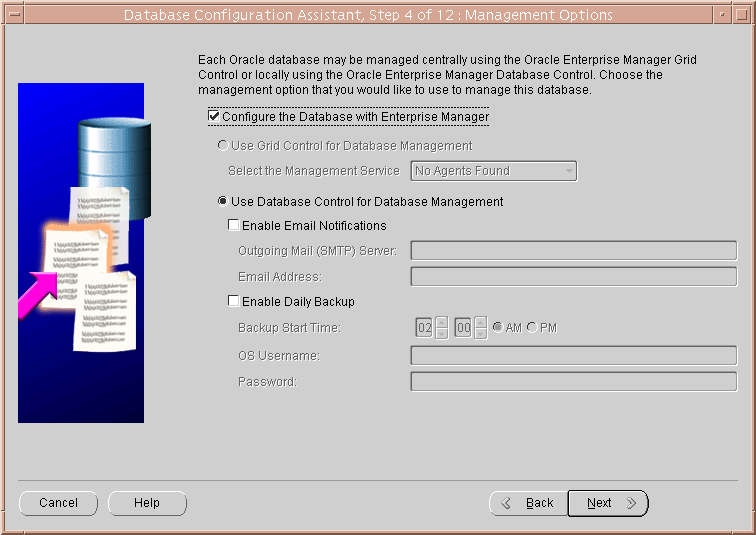

Advance to the Management Options page (Figure 1-4) and select the following options:
Configure the Database with Enterprise Manager
Use Database Control for Database Management
Optionally, select the options for enabling e-mail notifications and enabling daily backups.
For more information about Enterprise Manager notifications and daily backups, click Help on the Management Options page.
Advance until the Finish button is available.
Click Finish to reconfigure the database so it uses Database Control.
