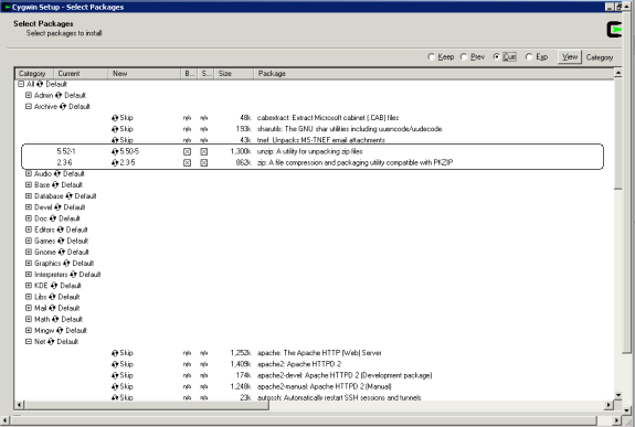

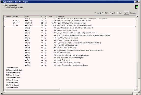

While installing Cygwin, ensure you choose the following binaries:
Zip, unzip binaries from the Archive package.
OpenSSH and dependencies (automatically selected if you choose OpenSSH) from the Net package.
