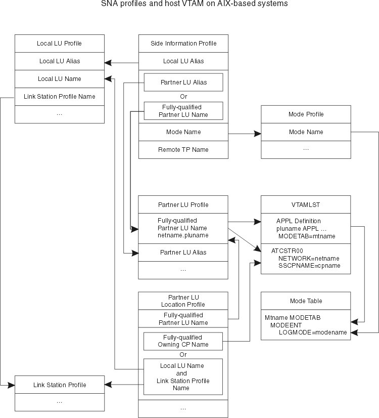

Figure 7-1 shows the relationship between SNA server profiles and the VTAM definitions on the host.
Figure 7-1 Relationship Between SNA Profiles and Host VTAM Definitions
