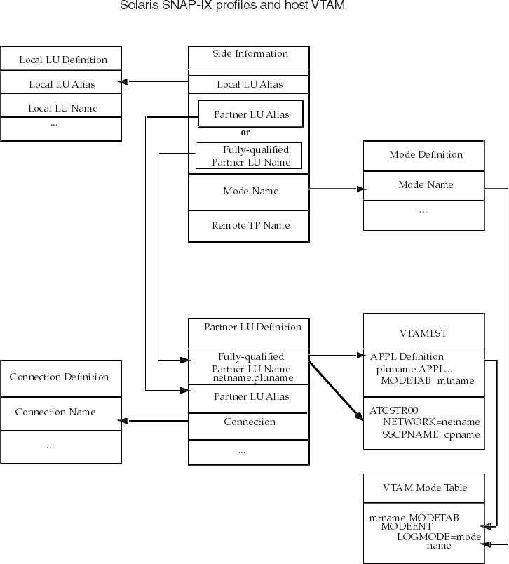

Figure 9-1 shows the relationship between SNAP-IX definitions and the VTAM definitions on the remote host.
Figure 9-1 Relationship Between SNAP-IX Definitions and Host VTAM Definitions
