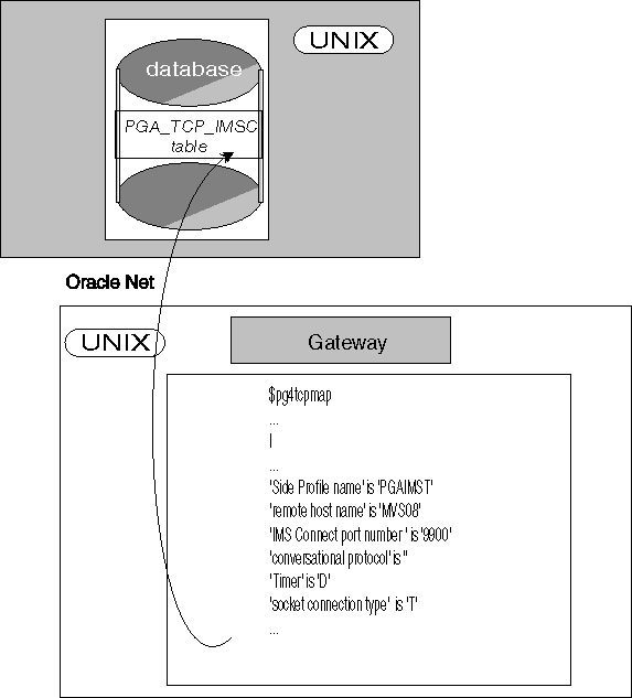

Figure 6-1 illustrates the relationship between the gateway, the database and the pg4tcpmap tool in mapping the Side Profile Name to TCP/IP and IMS Connect attributes in the PGA_TCP_IMSC table.
Figure 6-1 Mapping SNA Parameters to TCP/IP Using the pg4tcpmap Tool
