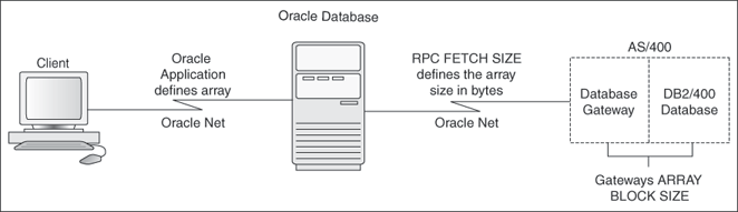

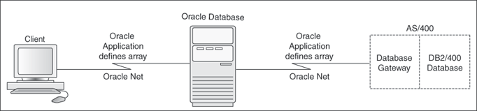

When evaluating and tuning your gateway configuration, you may achieve performance gains by using the Oracle Array Processing interface. An array is a collection of data items, called elements, that are associated with a single variable. With arrays, you can use a single SQL statement to manipulate an entire collection of data items. For example, suppose you want to insert information regarding 100 employees into the EMP
table on DB2/400. Without arrays, your program must do 100 individual INSERT
s, one for each employee. With arrays, only one INSERT
is necessary.
The use of array processing reduces network calls, which may save elapsed time and CPU cycles. In addition, when using INSERT
for multiple rows, DB2/400 processing is optimized by retaining the original SQL statement for repeated execution.
The array size is a factor in transferring data between the client application (for example, SQL*Plus) and the Oracle integrating server when using UPDATE
, DELETE
, and INSERT
statements, in that it allows one UPDATE
, DELETE
, or INSERT
statement to be used with a series of values. For more information about array processing usage and implementation in the Oracle application, refer to Oracle Database SQL Reference.
Figure 9-1 Use of Array Size Definition in the DB2/400 Architecture for UPDATE, DELETE, and INSERT
For performance reasons, Oracle recommends setting the initial Oracle application array size between 10 and 100.The array size of the application for SELECT
is effective between the application and the Oracle Database 10g server. However, the block size of the buffer between the Oracle integrating server and the gateway is governed by two initialization parameters, RPC FETCH SIZE
and RPC FETCH REBLOCKING
. These gateway initialization parameters correspond to the Heterogeneous Services initialization parameters HS_RPC_FETCH_SIZE
and HS_RPC_FETCH_REBLOCKING
, respectively. Figure 9-2 illustrates this. Refer to Oracle Database Administrator's Guide for more information.
With release 10 of the gateway, the Oracle Database 10g server supports fetch reblocking with the RPC FETCH REBLOCKING
parameter. When the value of this parameter is set to *YES
(the default), the block size of the buffer for SELECT
statements is determined by the RPC FETCH SIZE
value. The RPC FETCH SIZE
parameter defines the number of bytes sent with each buffer from the gateway to the Oracle Database 10g server. The buffer might contain one or more qualifying rows from DB2/400. This feature can provide significant performance enhancements, depending on your application design, installation type, and workload. The RPC
FETCH REBLOCKING
and RPC FETCH SIZE
parameters may be changed by using the CHGORATUN
command. Refer to "CHGORATUN, Change Initialization Parameters" for more information.
The array size between the client and the Oracle Database 10g server is still determined by the Oracle application. To ensure optimal performance, Oracle Corporation recommends that you set your Oracle application array size equal to the setting of the gateway ARRAY BLOCK SIZE
parameter. For more information about the gateway ARRAY BLOCK SIZE
parameter, refer to "Setting Optional Parameters". For more information about array processing usage and implementation in your Oracle application, refer to Oracle Database SQL Reference.
Figure 9-2 Array Size Definition in the DB2/400 Architecture for SELECT

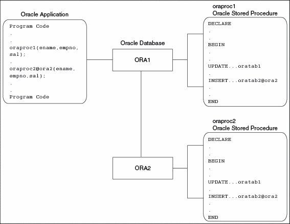

The gateway stored procedure support is an extension of Oracle stored procedures. An Oracle stored procedure is a schema object that logically groups a set of SQL and other PL/SQL programming language statements together to perform a specific task. Oracle stored procedures are stored in the database for continual use. Applications use standard Oracle PL/SQL to invoke stored procedures. There are no other ways to invoke a stored procedure.
Oracle stored procedures can be located in a local instance of Oracle and a remote instance. Figure 9-3 shows two stored procedures. oraproc1
is a procedure stored in the ORA1
Oracle instance, while oraproc2
is a procedure stored in the ORA2
Oracle instance.
Figure 9-3 Calling Oracle Stored Procedures in a Distributed Oracle Environment
If the application needs to maintain location transparency, then a synonym can be created:
CREATE SYNONYM ORAPROC2 FOR oraproc2@ora2;
where oraproc2
is the procedure that is stored in ORA2.
After this synonym is created, the application no longer needs to use the database link specification for invoking the stored procedure at the remote Oracle instance.
In Figure 9-3, the INSERT
statement in oraproc1
is used to access a table in the ORA2
instance. In the same way, Oracle stored procedures can be used to access DB2/400 tables through the gateway.

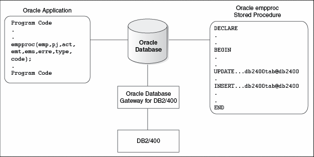

In Figure 9-4, empproc
is an Oracle stored procedure that subsequently accesses data in DB2 by using the Oracle Database Gateway for DB2/400.
Figure 9-4 Using Oracle Stored Procedures with DB2/400
As with the Oracle gateway, standard PL/SQL is used to create and execute the procedure. There is no difference in the gateways except that the stored procedure is accessing DB2/400 instead of an Oracle Database.

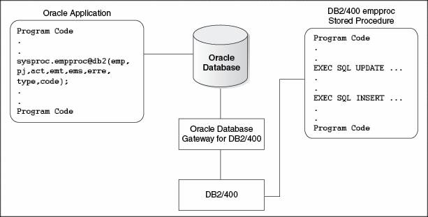

The procedural feature of the gateway enables execution of native DB2/400 stored procedures. In other words, the stored procedure is no longer defined in the Oracle Database but instead is defined to DB2/400. Again, standard Oracle PL/SQL is used by the Oracle application to execute the DB2/400 stored procedure.
The gateway does not require special definitions in order to invoke the DB2/400 stored procedure. After the stored procedure is defined to DB2/400, the gateway will be able to use the existing DB2/400 definition to execute the procedure.
In Figure 9-5, an Oracle application calls the empproc
stored procedure that is defined to DB2/400.
Figure 9-5 Executing DB2/400 Stored Procedures
From the perspective of the application, executing the DB2/400 stored procedure is no different than invoking a stored procedure at a remote Oracle Database instance.

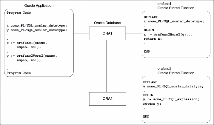

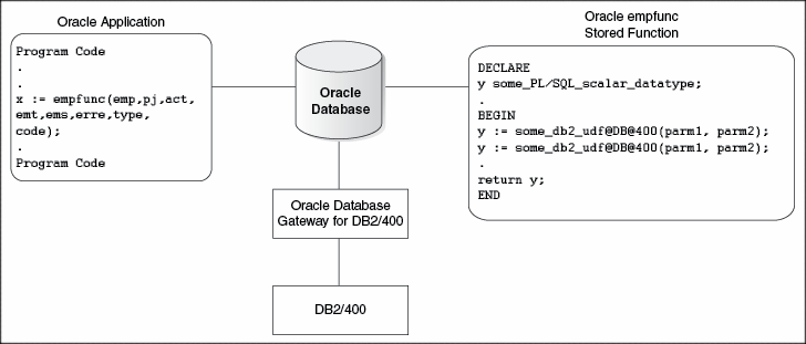

The gateway stored function support is an extension of Oracle stored functions. An Oracle stored function is a schema object that logically groups a set of SQL and other PL/SQL programming language statements together to perform a specific task and to return a value to the invoker of that function. Applications may use standard Oracle PL/SQL to invoke a stored function; an Oracle stored function may also be invoked as part of an Oracle SELECT
, INSERT
, DELETE
, or UPDATE
statement.
Similar to Oracle stored procedures, an Oracle stored function can be located in a local instance of Oracle and in a remote instance. Figure 9-6 shows two stored functions, orafunc1
is a function stored in the ORA1
Oracle instance, while orafunc2
Oracle instance.
Figure 9-6 Calling Oracle Stored Function in a Distributed Oracle Environment
CREATE SYNONYM ORAFUNC2 FOR orafunc2@ora2;
where orafunc2
is the function that is stored in ORA2.
After this synonym is created, the application no longer needs to use the database link specification for invoking the stored function at the remote Oracle Database.
In Figure 9-6, the reference to function orafunc2
is used to call that same function in the ORA2
instance. In the same way, Oracle can be used to access DB2/400 user-defined functions through the gateway.

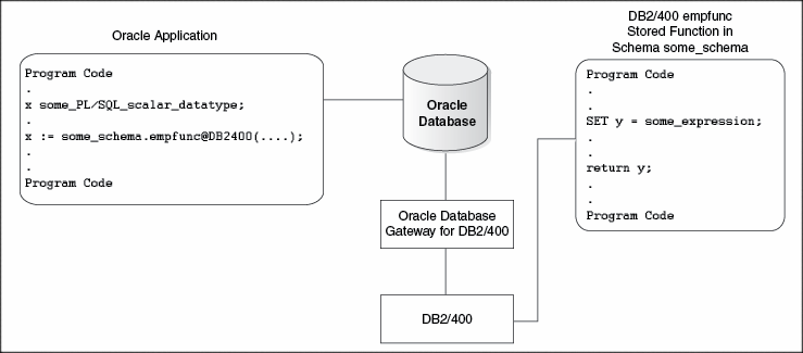

In Figure 9-7, empfunc is an Oracle stored function that subsequently accesses data in DB2/400 using the gateway.
Figure 9-7 Using Oracle Stored Functions with DB2/400
As with the Oracle database, standard PL/SQL is used to create the function. Standard PL/SQL may be used to execute the function or the function may be executed with a reference in a SQL command such as SELECT
, UPDATE
, INSERT
, or DELETE
. There is no difference in the gateway case except that the stored function is accessing DB2/400 rather than the Oracle database.
Oracle assumes that the underlying user defined function on the DB2/400 does not change any data on the AS/400 side if the stored function is referenced in a SQL command. One explicitly declares that a stored function does not change the AS/400 data by specifying that function name in an IFS file named /HOME/

In Figure 9-8, an Oracle application calls the empfunc
stored function that is defined in DB2/400.
Figure 9-8 Executing DB2/400 Stored Functions
From the perspective of the application, executing the DB2/400 stored function is no different that invoking a stored function at a remote Oracle instance.
