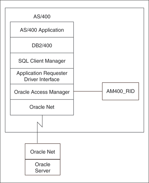

Oracle Access Manager for AS/400 enables AS/400 applications to update data on both the AS/400 and remote Oracle servers during a single transaction. Any time that updates are allowed in a distributed environment, a new level of complexity is introduced. When multiple users are sharing and accessing data that exists at many sites, rather than at a single site, these distributed transactions require careful management.
With Oracle Access Manager for AS/400, you now have the option to ensure that all participants (nodes) in a distributed transaction react unanimously to the action to take when a transaction end. That is, they all commit, or they all roll back.
For a database to fully participate in a two-phase commit transaction, it must support both a prepare phase and a commit phase for communicating transactions. The prepare phase ensures that all participating nodes that are referenced in a distributed transaction are prepared to commit or to abort the transaction, regardless of intervening failures. The prepare phase is performed when a COMMIT

Access Manager operates under AS/400 commitment control, including implied commits (defined in section "Implied commit"). Refer to the appropriate IBM AS/400 documentation for additional information.An in-doubt transaction occurs when a program or operation terminates abnormally before committing or rolling back the transaction. This creates an outstanding transaction, which must be resolved in order to free the involved resources and to ensure transaction consistency.
In-doubt transactions can be resolved automatically by Oracle Access Manager for AS/400. Oracle Access Manager uses a separate task to resolve in-doubt transactions. This task runs in its own subsystem and must be active to enable two-phase commit processing. The task runs the AM400_RID program. On the WRKACTJOB
display, the AM400_RIDI job will be seen to be active in the "lib" system (where "lib" is the name of the install library).
The AM400_RID program controls the automatic resolve-in-doubt processing for Oracle Access Manager for AS/400. This program runs in its own subsystem parallel to user programs. It is not called by user programs. The ability to perform resolve-in-doubt processing is required if two-phase commit was requested on the CHGSQLDFLT
command through the "Access Manager Two-Phase Commit" line by specifying *YES
to that option. The AM400_RID program performs resolve-in-doubt processing only for those Oracle Servers to which it has a valid connection. The only Oracle Servers to which the AM400_RID program might have a valid connection are those named in the list of Oracle Servers on the first page of the CHG2PCPRM
command (the AM400_COM, see later, can actually be used to dynamically add Oracle Servers to that list). When a user attempts to CONNECT
, the Access Manager queries the status of the AM400_RID program to see if it has a valid connection to the same Oracle Server to which the user is attempting to CONNECT
. If it does, then the user connection is allowed. If it does not have a valid connection, then the user CONNECT
fails.
Resolve-in-doubt processing actually occurs very rarely. It usually occurs due to some catastrophic failure. But it is required in order to keep data in a consistent state among the systems performing a distributed transaction. Informational messages are sent from the Access Manager program to the AM400_RID program every time a transaction changes status. No user data is sent in these messages.The Oracle user ID specified for each connection that AM400_RID has with an Oracle Server must have rather high privileges. User ID (and password) are specified on the second screen of the CHG2PCPRM
command when you are adding or modifying a possible connection. See Section 7.6, Oracle required privileges for further information.
As a transaction progresses, the Access Manager sends status messages to the AM400_RID program. The AM400_RID program does not send anything back to the Access Manager. In this manner, the AM400_RID program is kept informed of the status of all Oracle Access Manager transactions.
