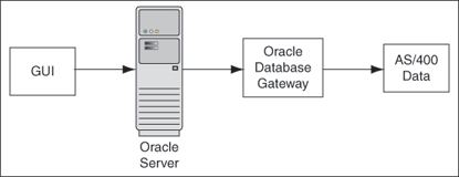

Oracle Database Gateway technology, combined with Oracle Access Manager products, allows you to fully integrate the AS/400 and Oracle systems. The Oracle Database Gateway for DB2/400 and the Oracle Database Gateway for DRDA provide Oracle users with access to AS/400 data as illustrated in Figure 1-1.

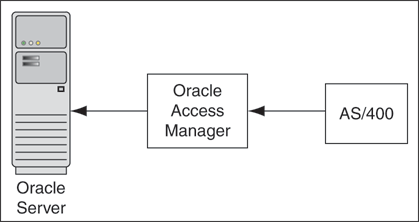

Oracle Access Manager provides AS/400 applications with access to Oracle data through SQL statements or stored procedures, as illustrated in Figure 1-2.
Oracle Access Manager for AS/400 provides OS/400 users with access (through DB2/400) to data that is residing on any supported Oracle platform by the use of Oracle SQL or Oracle stored procedures. Oracle Access Manager connects to the Oracle environment through Oracle Net. The connection from the AS/400 to an Oracle server uses TCP/IP.
Access Manager takes advantage of the IBM Application Requester Driver (ARD) interface to access an Oracle server. For a description of this interface, refer to the IBM document for System API Reference.
Access Manager allows direct access to Oracle data from existing AS/400 applications that are written in C, COBOL, or RPG, or from the AS/400 Interactive Query Manager product (STRSQL). Access Manager intercepts SQL statements during program execution and directs them to the Oracle server.

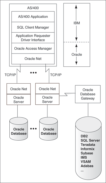

Figure 1-3 shows the architecture of Oracle Access Manager for AS/400.
Figure 1-3 Oracle Access Manager for AS/400 Architecture
The components interact in the following ways:
Table 1-1 Access Manager Component Interactions
| Component | Interaction |
performs processing and invokes embedded SQL to run SQL statements and retrieve results. |
manages connections, receives requests from the application, calls the ARD interface to process SQL requests if the connection is to Oracle, and returns results to the application. |
provides an interface between SQL Client Manager and Access Manager. |
processes procedure calls, submits SQL requests to the Oracle server, and returns results to SQL Client Manager. It also modifies requests, if necessary, so that they conform to Oracle server syntax. |
receives requests from the network and formats them to access Oracle data, then returns results over the network to the client. |
allows databases and their applications to reside on different computers and to communicate as peer applications in a Transparent Networking Substrate (TNS). |
