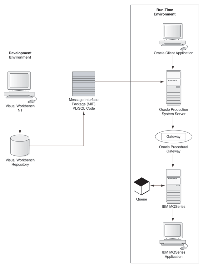

1.3 The PG4MQ Visual Workbench Development Environment
The PG4MQ Visual Workbench simplifies the development work necessary to access message queuing applications through the gateway. The PG4MQ Visual Workbench does this by handling data conversion between incompatible data types in messages exchanged between Oracle applications and non-Oracle message queuing applications.
The PG4MQ Visual Workbench has two components:
  • Visual Workbench
  • Visual Workbench repository
Use the Visual Workbench to develop interface profiles that contain the information necessary to communicate with other message queuing applications. The Visual Workbench stores the interface profile information in the Visual Workbench repository. Using the Visual Workbench, you compile the interface profile, producing a MIP that contains the PL/SQL code needed for Oracle applications to communicate with non-Oracle message queuing applications in a run-time environment. You provide MIP templates as a starting point for your application to use the MIP, and then compile and test the MIP on the production server.
Figure 1-1 illustrates the PG4MQ Visual Workbench's development and run-time environments.
Figure 1-1 Development Environment
Description of Figure 1-1 follows
Description of "Figure 1-1 Development Environment"
1.3.1 The PG4MQ Visual Workbench
The Visual Workbench (one for each developer) simplifies the work needed to access message queuing applications through the gateway. Use the Visual Workbench to:
  • create data profiles
  • create message queue profiles
  • create interface profiles
  • generate a MIP
  • Test the gateway and compile the MIP in the development environment
  • Provide MIP templates to use as a starting point for development
  • Compile the MIP and test it on the production system
The MIP uses the profile information you provide, enabling communication between an Oracle application and a non-Oracle message queuing application.

The Visual Workbench uses the interface profile information to generate a MIP, a PL/SQL package that provides a high-level interface between Oracle applications and non-Oracle message queuing applications. To create an interface profile you specify:
  • One data profile
  • One message queue profile
  • A unique name for the interface
  • The database link for communication between Oracle and a message queuing system, through the gateway
After you have defined the interface profile, the Visual Workbench automatically generates a MIP based on the interface profile information you specified. A MIP is a PL/SQL interface to send messages to, and retrieve messages from, a non-Oracle message queuing system.
When you generate a MIP, the Visual Workbench produces the MIP itself, data conversion code, and templates that show how to access the message queuing system using the MIP.
Using the Visual Workbench, you can install the generated MIP on any Oracle server where your application is running.

1.3.2 The PG4MQ Visual Workbench Repository
The Visual Workbench repository stores all data profiles, message queue profiles, interface profiles, and MIPs. The repository resides in an Oracle server and can be created in any Oracle server in the network. The Oracle server used for the repository need not be the same Oracle server that is used in the production system by the applications referencing the MIPs, it can be a different Oracle server.
