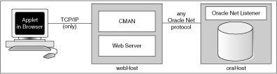

The Oracle Connection Manager is a lightweight, highly-scalable program that can receive Oracle Net packets and re-transmit them to a different server. To a client running Oracle Net, the Connection Manager looks exactly like a database server. An applet that uses the JDBC Thin driver can connect to a Connection Manager running on the Web server host and have the Connection Manager redirect the Oracle Net packets to an Oracle server running on a different host.
Figure 6-1 illustrates the relationship between the applet, the Oracle Connection Manager, and the database.
Figure 6-1 Applet, Connection Manager, and Database Relationship
Using the Oracle Connection Manager requires two steps:
Install and run the Connection Manager.
Write the connection string that targets the Connection Manager.

The following example describes the configuration illustrated in Figure 6-1. The Web server on which the Connection Manager is running is on host webHost
and is listening on port 1610
. The database to which you want to connect is running on host oraHost
, listening on port 1521
, and SID ORCL
. You write the URL in TNS keyword-value format:
String myURL = "jdbc:oracle:thin:@(description=(address_list= (address=(protocol=tcp)(port=1610)(host=webHost)) (address=(protocol=tcp)(port=1521)(host=oraHost))) (connect_data=(INSTANCE_NAME=orcl)) (source_route=yes))"; OracleDataSource ods = new OracleDataSource(); ods.setURL(myURL); ods.setUser("scott"); ods.setPassword("tiger"); Connection conn = ods.getConnection();
The first element in the address_list
entry represents the connection to the Connection Manager. The second element represents the database to which you want to connect. The order in which you list the addresses is important.
When your applet uses a URL, such as the preceding one, it will function exactly as if it were connected directly to the database on the host oraHost
