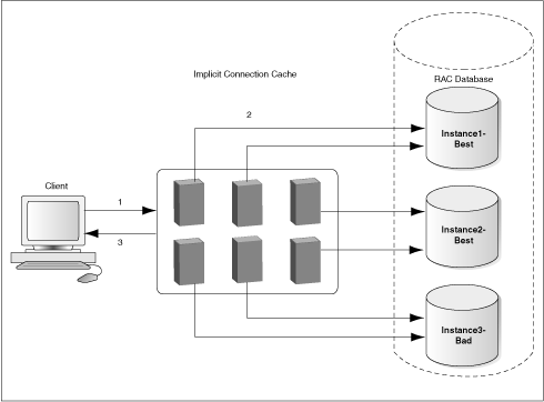

Figure 24-1 illustrates run-time connection load balancing. When run-time connection load balancing is enabled on the implicit connection cache, the following steps occur:
A client requests a connection from the connection cache by calling the getConnection
method on the DataSource
object.
The run-time connection load balancing mechanism selects the connection that belongs to the best instance from the connection cache. In Figure 24-1, this could be either Instance1 or Instance2.
The client receives the connection that would process the work request with the best response time.
Figure 24-1 Run-Time Connection Load Balancing
