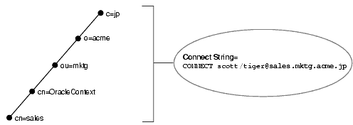

Absolute Names for X.500 Namespaces For X.500 namespaces, the default directory entry defined for the client must be in one of the following formats:
[ou],o
[ou],o,c
where [ou]
represents an optional organizationalUnitName.
The absolute name the client uses as the connect identifier must be in one of the following formats:
cn[.ou].o
cn[.ou].o.c
where [cn]
represents the Oracle Net entry.
For example, consider a client that has been configured with a default Oracle Context of cn=OracleContext,ou=acctg,o=acme,c=us
The directory contains database object sales
with a DN of cn=sales,cn=OracleContext,ou=mktg,o=acme,c=jp
. In this scenario, the client requires a connect identifier of sales.mktg.acme.jp
(cn.ou.o.c
). Figure 15-1 depicts this example.
Figure 15-1 Absolute Name for X.500 Namespaces

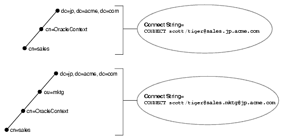

Absolute Names for Domain Component Namespaces For domain component namespaces, the default directory entry defined for the client must be in one of the following formats:
dc[,dc][...]
ou,dc[,dc][...]
where [dc]
represents an optional domain component and [...]
represents additional domain component entries.
The absolute name the client must use in the connect identifier must be in one of the following formats:
cn.dc[.dc][...]
cn[.ou]@dc[.dc][...]
where [cn]
Consider a client that has been configured with a default Oracle Context of cn=OracleContext,dc=us,dc=acme,dc=com
The directory server contains an entry for database object sales
with a DN of cn=sales,cn=OracleContext,dc=jp,dc=acme,dc=com
. In this scenario, the client requires a connect identifier of sales.jp.acme.com
(cn.dc.dc.dc
). Figure 15-2 depicts this example.
Consider the same default directory entry as Example 1. The directory server contains database object sales
with a DN of cn=sales,cn=OracleContext,ou=mktg,dc=jp,dc=acme,dc=com
. Notice ou=mktg
. Because domain components must be separated from organization units, the client requires a connect identifier of sales.mktg@jp.acme.com
(cn.ou@dc.dc.dc
Figure 15-2 Absolute Name for Domain Component Namespaces
