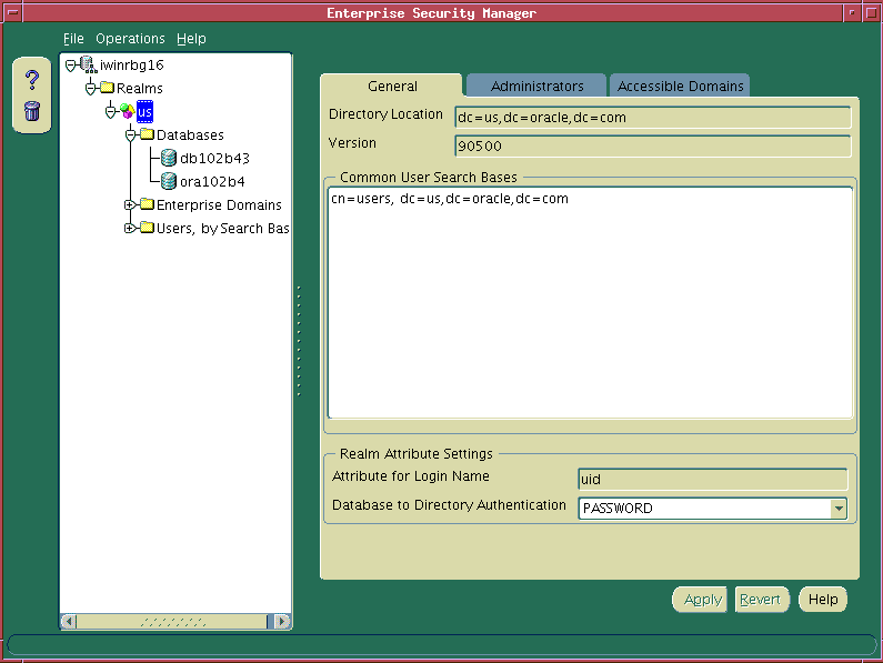

To set the default database-to-directory authentication type for an identity management realm:
Select the identity management realm in the left navigator pane.
Select the General tab in the right main window. See Figure 4-1.
In the Realm Attribute Settings region of the General tabbed window, select either PASSWORD or SSL from the Database to Directory Authentication list.
Click Apply to save your changes to the directory.

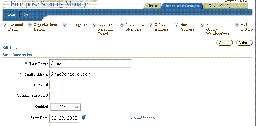

You can set and maintain enterprise user passwords in the Basic Information region of the Enterprise Security Manager Console Edit User window (Figure 4-3).
Figure 4-3 Enterprise Security Manager Console Edit User Window: Basic Information
The enterprise user password is used for:
Directory logon
Database logon, to databases that support password authentication for global users
To set the password for an enterprise user:
Navigate to the Enterprise Security Manager Console home page. (Select Launch Enterprise Security Manager Console from the Operations menu and log in using your OracleAS Single Sign-On user name and password.)
Select the Users and Groups tab.
In the Users and Groups tabbed window, select the User subtab, if it is not already displayed.
In the User subtab window, enter part of the enterprise user's user name (login name) or e-mail address, and click Go.
A list of all users who match your search criteria displays.
Select the user for whom you wish to create a new password, and click Edit.
In the Edit User window, enter the new password, and click Submit.

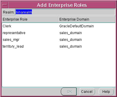

When you create a new enterprise user, you can grant any previously configured enterprise roles to the new user.
To assign existing enterprise roles to a new enterprise user:
In the left navigator pane, select the Users icon under the Users, By Search Base folder, which is displayed under the identity management realm you are using. The list of users is displayed in the right main window.
Select a user in the main window, and click Edit. An Edit User window displays.
Select the Enterprise Roles tab of the Edit User window, and click Add.
The Add Enterprise Roles window appears (Figure 4-4):
Figure 4-4 Enterprise Security Manager: Add Enterprise Roles Window
Select the correct identity management realm, then select any enterprise roles in your realm to assign to the new user, and click OK.

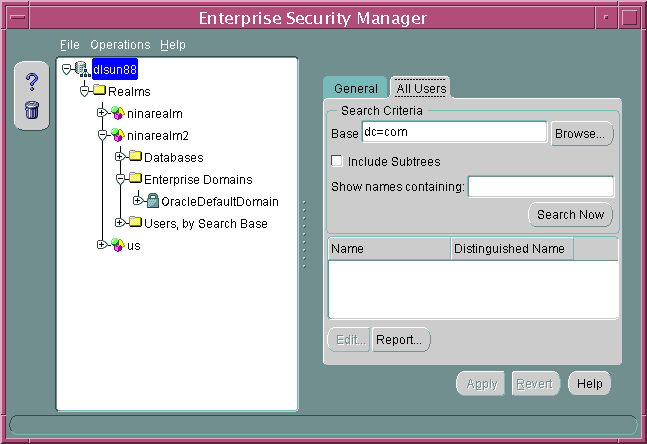

To browse enterprise users in the directory by using the All Users tab in the main application window:
Select the directory in the left navigator pane.
Select the All Users tab in the right main window (Figure 4-5):
Figure 4-5 Enterprise Security Manager: Main Window (All Users Tab)
Define the search criteria and click Search Now. The window displays the results of the search. Table 4-3 summarizes the search criteria and their respective effects on the search results.

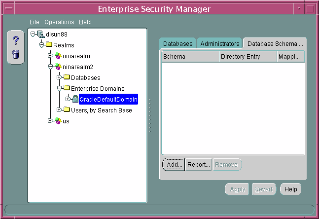

An identity management realm contains an enterprise domain called OracleDefaultDomain. OracleDefaultDomain is part of the realm when it is first created in the directory. When a new database is registered into a realm, it automatically becomes a member of OracleDefaultDomain in that realm. You can create and remove your own enterprise domains, but you must not remove OracleDefaultDomain from a realm.
This section describes how to use Enterprise Security Manager to administer enterprise domains in the directory. It contains the following topics:
If you do not want to use OracleDefaultDomain, then you can create a new enterprise domain in your identity management realm.

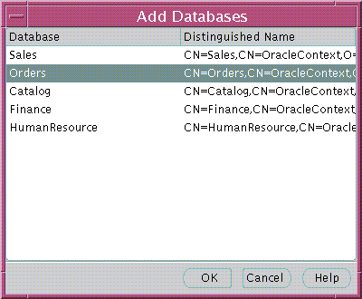

To add a database to an enterprise domain:
Note: The following restrictions apply to adding databases to an enterprise domain:
Click Add. The Add Databases window appears. This window lists all the databases that are not part of any domain associated with the realm(Figure 4-8):
Figure 4-8 Enterprise Security Manager: Add Databases Window
Select a new database to be added to the enterprise domain.
Click OK. The selected database is added to the list of databases in the Databases tabbed window (Figure 4-7).
Click Apply (Figure 4-7). The new database is added to the enterprise domain.

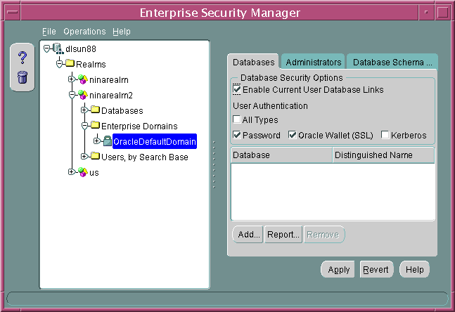

Use the Databases tabbed window (Figure 4-7) to manage database security options applicable to all databases that are members of the enterprise domain.
Database security options are summarized in Table 4-4:
Table 4-4 Enterprise Security Manager Database Security Options
| Database Security Option | Description |
| Enable current user database links | Any database pair can permit use of Current User Database Links only if both databases exist in the same enterprise domain where this setting is enabled. By default, current user database links are not enabled. |
| User authentication | All databases in an enterprise domain allow one, or more, of the following types of authentication for clients:

Database schema mappings, also referred to as user schema mappings, enable databases registered in the directory to accept connections from users without requiring any dedicated database schemas for them. For example, when local user Scott connects to a database, that logon can succeed only if a database schema called Scott exists. This requirement can be difficult to maintain if an enterprise has thousands of users and hundreds of databases.
Users defined in an LDAP-compliant directory do not require dedicated schemas on every Oracle9i or later database to which they might connect.
A database can use a schema mapping to share one database schema among multiple directory users. Each schema mapping is a pair of values, the base in the directory at which users exist and the name of the database schema they will use.
After selecting either a database or a domain in the main application tree, you can use the Database Schema Mappings window to manage database schema mappings. If a domain is selected, these mappings apply to all databases in the enterprise domain. However, for the mapping to be effective in a database, that database must have a schema with the name used in the mapping. This window contains a list of database schema names, directory DNs, and mapping types (Figure 4-9):
Figure 4-9 Enterprise Security Manager: Database Schema Mappings Tab

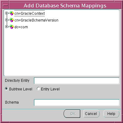

To add a new mapping to the list of database schema mappings in the enterprise domain:
In the Database Schema Mapping tabbed window, click Add.
The Add Database Schema Mappings window appears (Figure 4-10).
The three components in this window are the directory search tree, the options for choosing either subtree or entry-level mapping, and the field for entering the schema name. (You select the user's DN or the base of users in the directory tree.)
In this window, you make the database schema mapping by selecting a base in the directory and pairing it with a database schema name, as the following steps illustrate.
Figure 4-10 Enterprise Security Manager: Add Database Schema Mappings Window
Navigate the directory to select a desired entry as a base for the database schema mapping. Although any directory entry can be selected, you should, for an entry-level mapping, select the actual user. For a subtree-level mapping, select the entry located above the subtree of users to be mapped. You can also edit the contents of the Directory Entry field in this window to manually define the base.
Note that subtree-level mapping is usually the most useful.
Click the option corresponding to your chosen mapping type, Subtree Level or Entry Level.
In the Schema field, enter the name of the database schema for which this Mapping will be made, and click OK. This schema name must be a valid name that identifies a shared schema already existing on that database. Your new database schema mapping appears in the database schema mappings window (Figure 4-9).
Click Apply. The new database schema mapping is added to the selected database or domain in the realm.
To remove a mapping from the list of database schema mappings in an enterprise domain:
Select a mapping by selecting from the Database Schema Mapping tabbed window.
Click Remove. The selected mapping is removed from the list.
Click Apply. The mapping is removed from the enterprise domain.

To configure password accessibility:
Select the enterprise domain in the left navigator pane.
Select the Databases tabbed window and select Password or All Types from the User Authentication methods listed. (See Figure 4-7)
Click Apply.

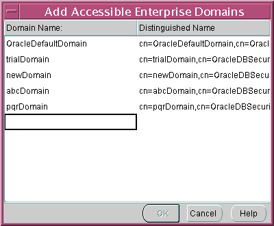

To add a domain to the Password-Accessible Domains List:
Select the Accessible Domains tabbed window and click Add. The Add Accessible Enterprise Domains dialog box appears. See Figure 4-11.
Figure 4-11 Enterprise Security Manager: Add Accessible Enterprise Domains Dialog Box
Select OracleDefaultDomain from the list of enterprise domains and click OK. OracleDefaultDomain is added to the list of domains in the Accessible Domains tab.
Click Apply. The new domain is added to the password accessible domains list in the directory.

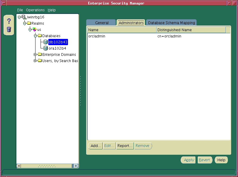

Database administrators are members of the directory administrative group OracleDBAdmins. They are directory users who have privileges to modify the database entry and its subtree in the realm. These privileges include creating and managing user-schema mappings. When a user registers a database in the directory, Database Configuration Assistant automatically puts that user into the OracleDBAdmins group.
Database administrators can be managed by using the Administrators tabbed window when a database is selected under a realm in the navigator pane. See Figure 4-12. Note that only OracleDBAdmins or OracleContextAdmins group members can add or remove users from the OracleDBAdmins group.
Figure 4-12 Enterprise Security Manager: Administrators Tab
To remove a user from the list of Database Administrators:
In the Administrators tabbed window, select a user from the list of administrators.
Click Remove. The selected user is removed from the list.
Click Apply. The user is removed as a Database Administrator for that database.
To add a new user to the list of Database Administrators:
Click Add in the Administrators tabbed window. The Add Users window appears. Use this window to locate and select users in the directory.
Select a user or users from the directory to be added as a database administrator. The new users are displayed in the Administrators tabbed window.
Click Apply. The new administrators are added to the database in the realm.

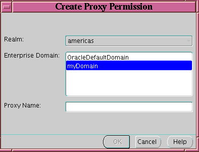

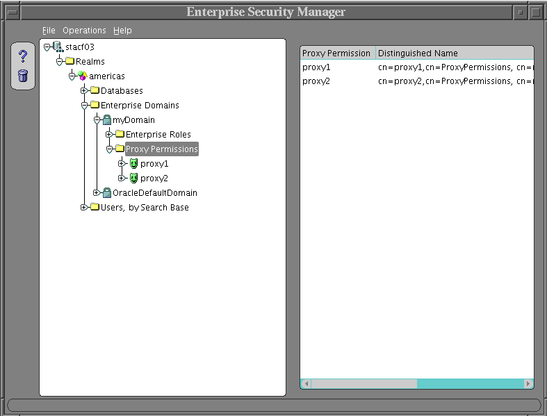

An enterprise domain within an identity management realm can contain multiple proxy permissions. A proxy permission object is a set of authorizations, which can be granted to enterprise users to proxy as local database users within the enterprise domain.
Selecting the Proxy Permissions node under a domain in the navigation tree shows two lists in the right main window of Enterprise Security Manager. The first list identifies the proxy permission names. The other list shows the corresponding DNs of the proxy permission entries in Oracle Internet Directory. Each proxy permission under the Proxy Permissions container includes a list of users and groups to which it applies. It also includes the list of target database users to which the proxy users are mapped.
To enable enterprise users to proxy as local database users, the following steps are required:
To allow enterprise users the right to proxy as local database users, an administrator must run the following command for each such local database user:
ALTER USER local_database_user_name GRANT CONNECT THROUGH ENTERPRISE USERS
This task requires the following steps to be performed in Enterprise Security Manager:
In the navigation tree, select the realm containing the domains in which you want to establish enterprise user proxies.
Select the domain containing the local databases to which users will proxy. From the Operations menu, choose Create Proxy Permission. The dialog box shown in Figure 4-13 appears.
Type a name for the proxy permission in the Proxy Name text field. Click OK.
Figure 4-14 illustrates how the newly created proxy permission entry appears in the navigation tree:
Figure 4-14 Tree View of New Proxies in Proxy Permissions

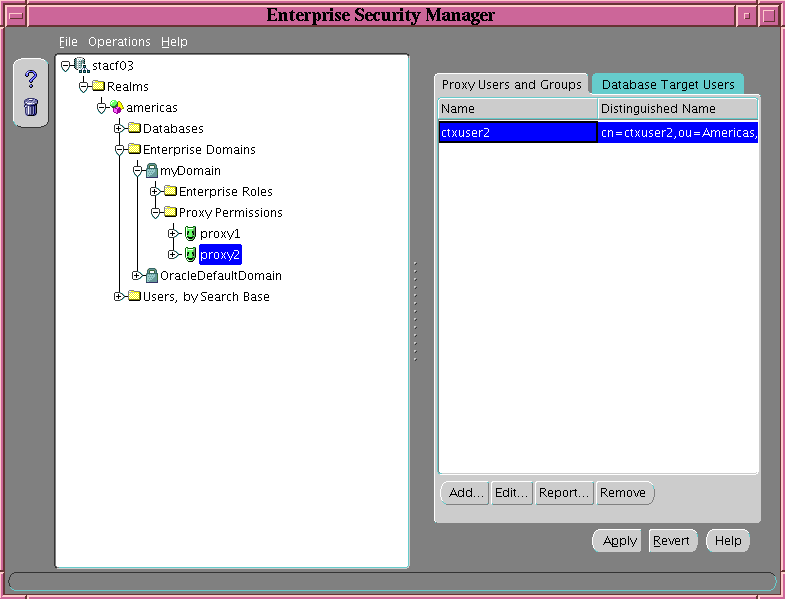

Select a proxy. The associated tabbed windows appear: one named Proxy Users and Groups, the other named Database Target Users, as shown in Figure 4-15.
Select the Proxy Users and Groups window and click Add. The Add Enterprise Users window appears.
Use the Add Enterprise Users window to select one or more enterprise users to be granted proxy permissions. Your window will look like Figure 4-16:
Click OK. Your selected enterprise user now appears as an enterprise user for proxy2, with his or her name and Distinguished Name in the Proxy Users and Groups tabbed window, as shown in Figure 4-17:
Click Apply.

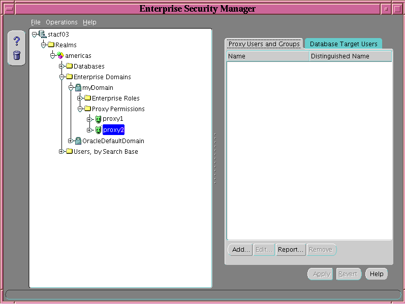

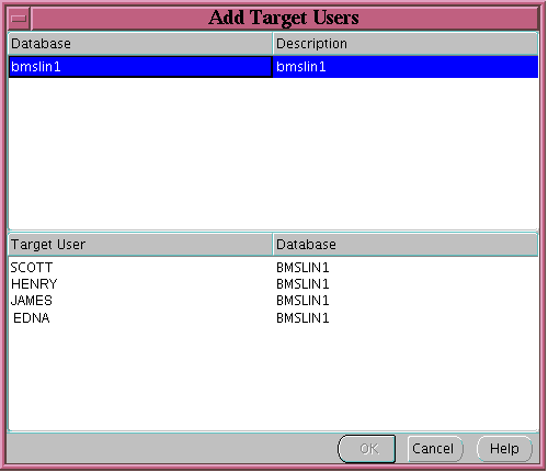

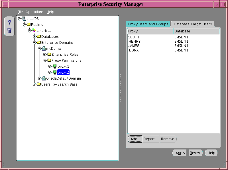

The preceding section identified the enterprise users who will be permitted to proxy as local database users. In this section, you select the target databases and local users to whom those enterprise users can proxy.

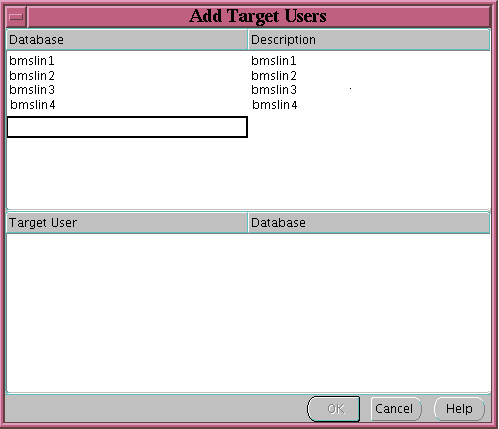

Select the Database Target Users tab and click Add.
The Add Target Users window appears as shown in Figure 4-18. It shows the available databases in the domain.

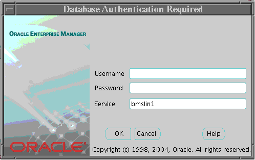

Select the desired database from which the target users will be chosen. The login screen for that database will appear, as illustrated in Figure 4-19.
After you log in, the available users will be listed as illustrated in Figure 4-20. (This list will include only those users for whom an earlier ALTER USER command was issued, as described in "Granting Enterprise Users Access to Local Database Schemas".)
Figure 4-20 Local Database Users Available as Proxy Targets
Select the users you want, and click OK. A screen similar to the one shown in Figure 4-21 appears.
When you click Apply, these local database users will be established as legitimate proxy targets for your selected enterprise users.

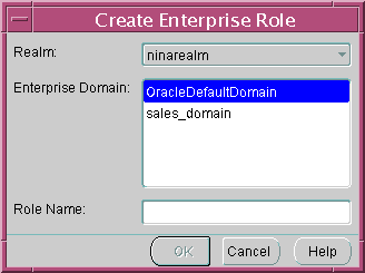

You can create an enterprise role in an enterprise domain either from the Operations menu on the Enterprise Security Manager main window (Figure 4-9), or by right-clicking an enterprise domain in the main application tree. In either case, the Create Enterprise Role window appears (Figure 4-22):
Figure 4-22 Enterprise Security Manager: Create Enterprise Role Window
To create a new enterprise role:
Select the identity management realm from the list. This realm contains the enterprise domain to hold the new enterprise role.
Note: If you invoked the Create Enterprise Role window by right-clicking an enterprise domain, then the name of the identity management realm is already selected. |
From the Enterprise Domain list, select the appropriate enterprise domain for the new enterprise role.
Note: If you invoked the Create Enterprise Role window by right-clicking an enterprise domain, then the name of the enterprise domain is already selected. |
Enter the name of the new enterprise role in the Role Name field.
Click OK. The new enterprise role is created in the enterprise domain and appears on the main application tree.

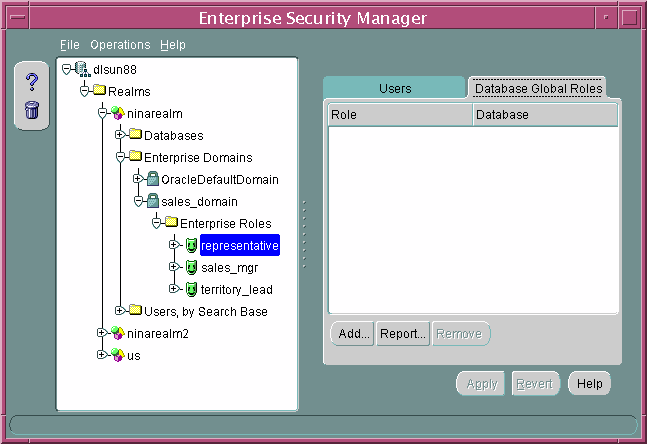

Use the Database Global Roles tabbed window (Figure 4-23) of the Enterprise Security Manager main window to manage database global role membership in an enterprise role. This window lists the names of each global role that belongs to the enterprise role, along with the name of the database on which that global role exists.
Figure 4-23 Enterprise Security Manager: Database Global Roles Tab
When populating an enterprise role with different database roles, you can only use roles configured to be global roles on the databases you select. A global role on a database is identical to a normal role, except that the database administrator has defined it to be authorized only through the directory (Global roles are created with the syntax, CREATE ROLE <role_name> IDENTIFIED GLOBALLY;). A database administrator cannot locally grant and revoke global roles to users of the database.
To add a global role to an enterprise role:
Click Add (Figure 4-23). The Add Global Database Roles window appears. This window lists all of the databases in the enterprise domain from which global roles can be selected to add to an enterprise role.

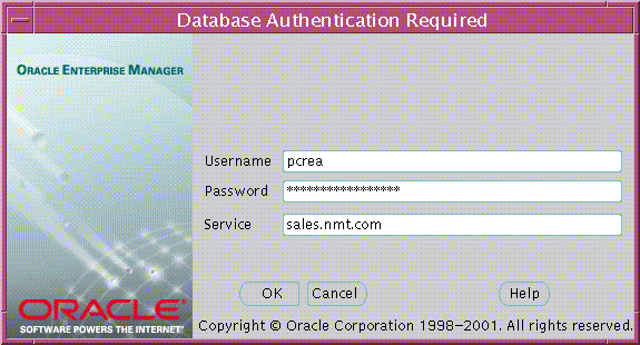

Select a database from which to obtain global roles. A window appears and prompts you for logon details to authenticate to the database (and fetch global roles). Typically, a DBA logon to that database is required.
Note that the name of the database appears in the Service field by default. You can use this name to connect to the database in two circumstances:
If your Oracle home has LDAP enabled as its Oracle Net naming method, or
If this name appears as a TNS alias in your local Oracle Net configuration
Otherwise, you can overwrite the content of the Service field with
any other TNS alias configured for that database, or
a connect string in the format <host>:<port>:<oracle sid>. For example, cartman:1521:broncos
Figure 4-24 Enterprise Security Manager: Database Authentication Required Window
Click OK. Enterprise Security Manager connects you to the given database and fetches the list of global roles supported on that database. The list of values, if any, is displayed in the Add Global Database Roles window.
Select one or more global roles from the list of returned values and click OK. These global roles appear in the Database Global Roles tabbed window (Figure 4-23).
Click Apply. The new global roles are added to the enterprise role in the enterprise domain.
To remove a database global role from an enterprise role:
Select a global role under the Database Global Roles tab, and click Remove. The global role is removed from the list.
Click Apply. The global role is removed from the enterprise role in the enterprise domain.

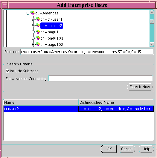

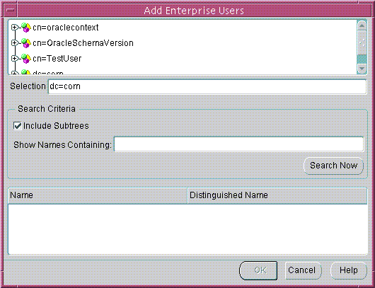

To grant an enterprise role to users:
Select the role in the navigation tree and click Add in the Users tabbed window. The Add Enterprise Users window appears. Use this window to locate and select one or more directory users to add as enterprise role grantees (Figure 4-25):
Figure 4-25 Enterprise Security Manager: Add Enterprise Users Window
Select a user or users and click OK. The new grantees are added to the list of users who have that enterprise role in the enterprise domain.
Click Apply. The user or users are granted the selected enterprise role.
