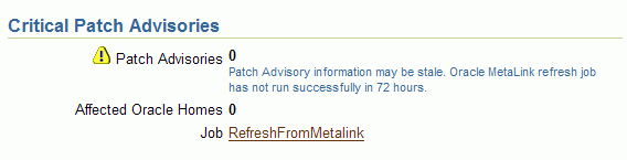

After you have configured the Oracle MetaLink credentials, you can create a job to search for critical patch advisories for your installed software.
To create a job to search for critical patch advisories on Oracle MetaLink, perform the following tasks:
On the Cluster Database Home page, scroll down the section titled Critical Patch Advisories. Click the link RefreshFromMetalink.
When you click this link, Enterprise Manager creates the Refresh_From_Metalink_Job job, and then displays the Job Activity page.
On the Job Activity page, click Edit and then modify the scheduled execution time of the Refresh_From_Metalink_Job job to meet your business requirements. When finished, click Save.
When returned to the Job Activity page, select the Refresh_From_Metalink_Job job and click Create Like. Change the job now to Refresh_From_Metalink_Now, then click Schedule. Select Immediately for the start time. Select One Time Only for the Repeat interval. Click Submit and Save.
When returned to the Job Activity page, click REFRESH_FROM_METALINK_NOW.
The Job Run: REFRESH_FROM_METALINK_NOW page is displayed.
Refresh this page until the job status shows Succeeded.
Click the Database tab in the upper right-hand corner to return to the Cluster Database Home page.
