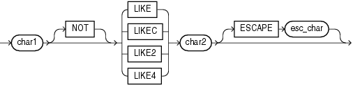

The pattern-matching conditions compare character data.
The LIKE
conditions specify a test involving pattern matching. Whereas the equality operator (=) exactly matches one character value to another, the LIKE
conditions match a portion of one character value to another by searching the first value for the pattern specified by the second. LIKE
calculates strings using characters as defined by the input character set. LIKEC
uses Unicode complete characters. LIKE2
uses UCS2 code points. LIKE4
uses UCS4 code points.
In this syntax:
char1
is a character expression, such as a character column, called the search value.
char2
is a character expression, usually a literal, called the pattern.
esc_char
is a character expression, usually a literal, called the escape character.

If esc_char
is not specified, then there is no default escape character. If any of char1
, char2
, or esc_char
is null, then the result is unknown. Otherwise, the escape character, if specified, must be a character string of length 1.
