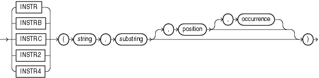

The INSTR
functions search string
for substring
. The function returns an integer indicating the position of the character in string
that is the first character of this occurrence. INSTR
calculates strings using characters as defined by the input character set. INSTRB
uses bytes instead of characters. INSTRC
uses Unicode complete characters. INSTR2
uses UCS2 code points. INSTR4
uses UCS4 code points.
position
is an nonzero integer indicating the character of string
where Oracle Database begins the search. If position
is negative, then Oracle counts backward from the end of string
and then searches backward from the resulting position.
occurrence
is an integer indicating which occurrence of string
Oracle should search for. The value of occurrence
must be positive.
Both string
and substring
can be any of the datatypes CHAR
, VARCHAR2
, NCHAR
, NVARCHAR2
, CLOB
, or NCLOB
. The value returned is of NUMBER
datatype.
Both position
and occurrence
must be of datatype NUMBER
, or any datatype that can be implicitly converted to NUMBER
, and must resolve to an integer. The default values of both position
and occurrence
are 1, meaning Oracle begins searching at the first character of string
for the first occurrence of substring
. The return value is relative to the beginning of string
, regardless of the value of position
, and is expressed in characters. If the search is unsuccessful (if substring
does not appear occurrence
times after the position
character of string
), then the return value is 0.
