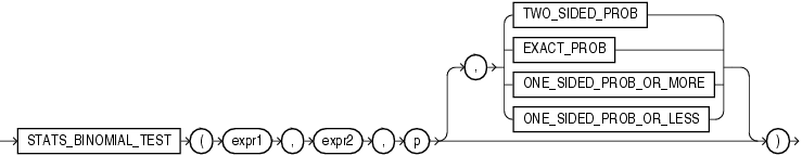

STATS_BINOMIAL_TEST is an exact probability test used for dichotomous variables, where only two possible values exist. It tests the difference between a sample proportion and a given proportion. The sample size in such tests is usually small.
This function takes four arguments: expr1 is the sample being examined. expr2 contains the values for which the proportion is expected to be, and p is a proportion to test against. The fourth argument is a return value of type VARCHAR2. If you omit the fourth argument, the default is TWO_SIDED_PROB. The meaning of the return values is shown in Table 5-3.

EXACT_PROB gives the probability of getting exactly proportion p. In cases where you want to test whether the proportion found in the sample is significantly different from a 50-50 split, p would normally be 0.50. If you want to test only whether the proportion is different, then use the return value TWO_SIDED_PROB. If your test is whether the proportion is more than the value of expr2, then use the return value ONE_SIDED_PROB_OR_MORE. If the test is to determine whether the proportion of expr2 is less, then use the return value ONE_SIDED_PROB_OR_LESS.
