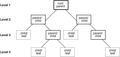

For each row returned by a hierarchical query, the LEVEL pseudocolumn returns 1 for a root row, 2 for a child of a root, and so on. A root row is the highest row within an inverted tree. A child row is any nonroot row. A parent row is any row that has children. A leaf row is any row without children. Figure 3-1 shows the nodes of an inverted tree with their LEVEL values.
