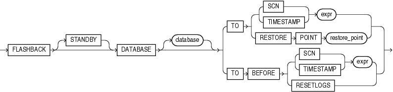

Use the FLASHBACK
DATABASE
statement to return the database to a past time or system change number (SCN). This statement provides a fast alternative to performing incomplete database recovery.

Oracle Database Backup and Recovery Advanced User's Guide for more information on recovering datafilesSpecify STANDBY
to revert the standby database to an earlier SCN or time. If the database is not a standby database, then the database returns an error. If you omit this clause, then database
can be either a primary or a standby database.

on a standby database to achieve different delaysSpecify a system change number (SCN):
TO SCN
reverts the database back to its state at the specified SCN.
TO BEFORE SCN
reverts the database back to its state at the system change number just preceding the specified SCN.

Specify a valid datetime expression.
TO TIMESTAMP
reverts the database back to its state at the specified timestamp.
TO BEFORE TIMESTAMP
reverts the database back to its state one second before the specified timestamp.

Specify this clause to flash back the database to the specified restore point. If you have not enabled flashback database, this is the only clause you can specify in this FLASHBACK
DATABASE
statement. If the database is not in FLASHBACK
mode, as described in the "Prerequisites" section above, this is the only clause you can specify for this statement.
Specify TO
BEFORE
RESETLOGS
to flash the database back to just before the last resetlogs operation (ALTER
DATABASE
OPEN
RESETLOGS
