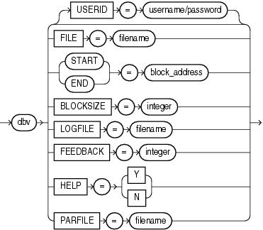

In this mode, DBVERIFY scans one or more disk blocks of a single datafile and performs page checks.
Note: If the file you are verifying is an Automatic Storage Management (ASM) file, you must supply aUSERID. This is because DBVERIFY needs to connect to an Oracle instance to access ASM files. |
The syntax for DBVERIFY when you want to validate disk blocks of a single datafile is as follows:

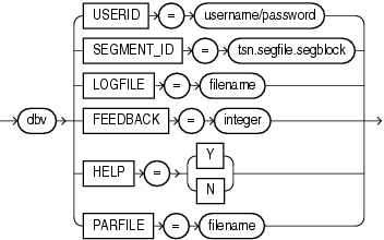

In this mode, DBVERIFY enables you to specify a table segment or index segment for verification. It checks to make sure that a row chain pointer is within the segment being verified.
This mode requires that you specify a segment (data or index) to be validated. It also requires that you log on to the database with SYSDBA privileges, because information about the segment must be retrieved from the database.
During this mode, the segment is locked. If the specified segment is an index, the parent table is locked. Note that some indexes, such as IOTs, do not have parent tables.
The syntax for DBVERIFY when you want to validate a segment is as follows:
