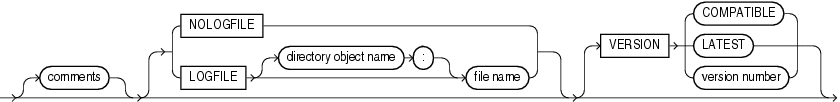

When you create the external table, you can specify certain parameters in an access_parameters
clause. This clause is optional, as are its individual parameters. For example, you could specify LOGFILE
, but not VERSION
, or vice versa. The syntax for the access_parameters
clause is as follows:
