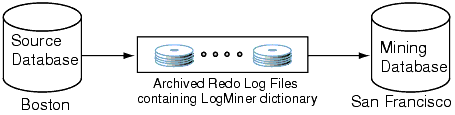

Figure 17-1 shows a sample LogMiner configuration. In this figure, the source database in Boston generates redo log files that are archived and shipped to a database in San Francisco. A LogMiner dictionary has been extracted to these redo log files. The mining database, where LogMiner will actually analyze the redo log files, is in San Francisco. The Boston database is running Oracle9i, and the San Francisco database is running Oracle Database 10g.
Figure 17-1 Sample LogMiner Database Configuration
Figure 17-1 shows just one valid LogMiner configuration. Other valid configurations are those that use the same database for both the source and mining database, or use another method for providing the data dictionary. These other data dictionary options are described in the section about LogMiner Dictionary Options.

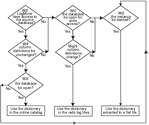

LogMiner requires a dictionary to translate object IDs into object names when it returns redo data to you. LogMiner gives you three options for supplying the dictionary:
Oracle recommends that you use this option when you will have access to the source database from which the redo log files were created and when no changes to the column definitions in the tables of interest are anticipated. This is the most efficient and easy-to-use option.
Extracting a LogMiner Dictionary to the Redo Log Files
Oracle recommends that you use this option when you do not expect to have access to the source database from which the redo log files were created, or if you anticipate that changes will be made to the column definitions in the tables of interest.
Extracting the LogMiner Dictionary to a Flat File
This option is maintained for backward compatibility with previous releases. This option does not guarantee transactional consistency. Oracle recommends that you use either the online catalog or extract the dictionary from redo log files instead.
Figure 17-2 shows a decision tree to help you select a LogMiner dictionary, depending on your situation.
Figure 17-2 Decision Tree for Choosing a LogMiner Dictionary
The following sections provide instructions on how to specify each of the available dictionary options.

To use LogMiner, you must supply it with a dictionary by doing one of the following:
Specify use of the online catalog by using the DICT_FROM_ONLINE_CATALOG option when you start LogMiner. See Using the Online Catalog.
Extract database dictionary information to the redo log files. See Extracting a LogMiner Dictionary to the Redo Log Files.
Extract database dictionary information to a flat file. See Extracting the LogMiner Dictionary to a Flat File.
Before you can start LogMiner, you must specify the redo log files that you want to analyze. To do so, execute the DBMS_LOGMNR.ADD_LOGFILE procedure, as demonstrated in the following steps. You can add and remove redo log files in any order.
Note: If you will be mining in the database instance that is generating the redo log files, you only need to specify theCONTINUOUS_MINE option and one of the following when you start LogMiner:
For more information, see Redo Log File Options. |

After you have created a LogMiner dictionary file and specified which redo log files to analyze, you must start LogMiner. Take the following steps:
Execute the DBMS_LOGMNR.START_LOGMNR procedure to start LogMiner.
Oracle recommends that you specify a LogMiner dictionary option. If you do not, LogMiner cannot translate internal object identifiers and datatypes to object names and external data formats. Therefore, it would return internal object IDs and present data as binary data. Additionally, the MINE_VALUE and COLUMN_PRESENT functions cannot be used without a dictionary.
If you are specifying the name of a flat file LogMiner dictionary, you must supply a fully qualified filename for the dictionary file. For example, to start LogMiner using /oracle/database/dictionary.ora, issue the following statement:
EXECUTE DBMS_LOGMNR.START_LOGMNR( - DICTFILENAME =>'/oracle/database/dictionary.ora');
If you are not specifying a flat file dictionary name, then use the OPTIONS parameter to specify either the DICT_FROM_REDO_LOGS or DICT_FROM_ONLINE_CATALOG option.
If you specify DICT_FROM_REDO_LOGS, LogMiner expects to find a dictionary in the redo log files that you specified with the DBMS_LOGMNR.ADD_LOGFILE procedure. To determine which redo log files contain a dictionary, look at the V$ARCHIVED_LOG view. See Extracting a LogMiner Dictionary to the Redo Log Files for an example.
Note: If you add additional redo log files after LogMiner has been started, you must restart LogMiner. LogMiner will not retain options that were included in the previous call toDBMS_LOGMNR.START_LOGMNR; you must respecify those options that you want to use. However, LogMiner will retain the dictionary specification from the previous call if you do not specify a dictionary in the current call to DBMS_LOGMNR.START_LOGMNR. |
For more information about the DICT_FROM_ONLINE_CATALOG option, see Using the Online Catalog.
