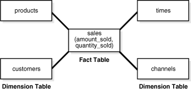

Data warehouses often use denormalized or partially denormalized schemas (such as a star schema) to optimize query performance.

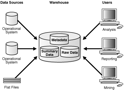

Figure 16-1 shows a simple architecture for a data warehouse. End users directly access data derived from several source systems through the data warehouse.
Figure 16-1 Architecture of a Data Warehouse
In Figure 16-1, the metadata and raw data of a traditional OLTP system is present, as is an additional type of data, summary data. Summaries are very valuable in data warehouses because they pre-compute long operations in advance. For example, a typical data warehouse query is to retrieve something like August sales.
Summaries in Oracle are called materialized views.

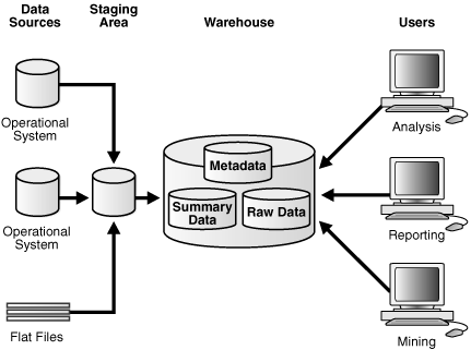

Figure 16-1, you need to clean and process your operational data before putting it into the warehouse. You can do this programmatically, although most data warehouses use a staging area instead. A staging area simplifies building summaries and general warehouse management. Figure 16-2 illustrates this typical architecture.
Figure 16-2 Architecture of a Data Warehouse with a Staging Area

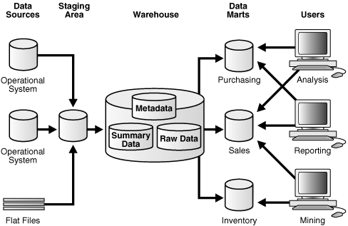

Although the architecture in Figure 16-2 is quite common, you might want to customize your warehouse's architecture for different groups within your organization.
Do this by adding data marts, which are systems designed for a particular line of business. Figure 16-3 illustrates an example where purchasing, sales, and inventories are separated. In this example, a financial analyst might want to analyze historical data for purchases and sales.
Figure 16-3 Architecture of a Data Warehouse with a Staging Area and Data Marts

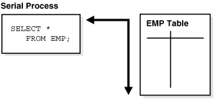

* FROM emp
), one process performs the entire operation, as illustrated in Figure 16-5.

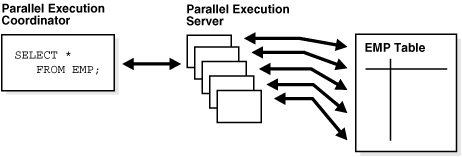

Figure 16-6 illustrates several parallel execution servers performing a scan of the table emp
. The table is divided dynamically (dynamic partitioning) into load units called granules and each granule is read by a single parallel execution server. The granules are generated by the coordinator. Each granule is a range of physical blocks of the table emp
. The mapping of granules to execution servers is not static, but is determined at execution time. When an execution server finishes reading the rows of the table emp
corresponding to a granule, it gets another granule from the coordinator if there are any granules remaining. This continues until all granules are exhausted, in other words, until the entire table emp
has been read. The parallel execution servers send results back to the parallel execution coordinator, which assembles the pieces into the desired full table scan.
Given a query plan for a SQL query, the parallel execution coordinator breaks down each operator in a SQL query into parallel pieces, runs them in the right order as specified in the query, and then integrates the partial results produced by the parallel execution servers executing the operators. The number of parallel execution servers assigned to a single operation is the degree of parallelism (DOP) for an operation. Multiple operations within the same SQL statement all have the same degree of parallelism.

Partitioning allows management of precise subsets of tables and indexes, so that management operations affect only small pieces of these data structures. By partitioning tables and indexes, data management processing time is reduced, thus minimizing the time data is unavailable. Transportable tablespaces also support high availability. With transportable tablespaces, large data sets, including tables and indexes, can be added with almost no processing to other databases. This enables extremely rapid data loading and updates.
Oracle lets you precisely control resource utilization. The Database Resource Manager, for example, provides a mechanism for allocating the resources of a data warehouse among different sets of end-users.
Another resource management facility is the progress monitor, which gives end users and administrators the status of long-running operations. Oracle maintains statistics describing the percent-complete of these operations. Oracle Enterprise Manager lets you view a bar-graph display of these operations showing what percent complete they are. Moreover, any other tool or any database administrator can also retrieve progress information directly from the Oracle data server using system views.
