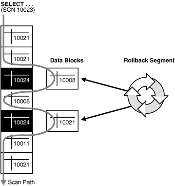

Oracle automatically provides read consistency to a query so that all the data that the query sees comes from a single point in time (statement-level read consistency). Oracle can also provide read consistency to all of the queries in a transaction (transaction-level read consistency).
Oracle uses the information maintained in its rollback segments to provide these consistent views. The rollback segments contain the old values of data that have been changed by uncommitted or recently committed transactions. Figure 13-1 shows how Oracle provides statement-level read consistency using data in rollback segments.
Figure 13-1 Transactions and Read Consistency
As a query enters the execution stage, the current system change number (SCN) is determined. In Figure 13-1, this system change number is 10023. As data blocks are read on behalf of the query, only blocks written with the observed SCN are used. Blocks with changed data (more recent SCNs) are reconstructed from data in the rollback segments, and the reconstructed data is returned for the query. Therefore, each query returns all committed data with respect to the SCN recorded at the time that query execution began. Changes of other transactions that occur during a query's execution are not observed, guaranteeing that consistent data is returned for each query.
Oracle always enforces statement-level read consistency. This guarantees that all the data returned by a single query comes from a single point in time—the time that the query began. Therefore, a query never sees dirty data or any of the changes made by transactions that commit during query execution. As query execution proceeds, only data committed before the query began is visible to the query. The query does not see changes committed after statement execution begins.

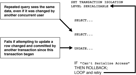

Oracle generates an error when a serializable transaction tries to update or delete data modified by a transaction that commits after the serializable transaction began:
ORA-08177: Cannot serialize access for this transaction
When a serializable transaction fails with the Cannot serialize access error, the application can take any of several actions:
Commit the work executed to that point
Execute additional (but different) statements (perhaps after rolling back to a savepoint established earlier in the transaction)
Undo the entire transaction
Figure 13-2 shows an example of an application that rolls back and retries the transaction after it fails with the Cannot serialize access error:
Figure 13-2 Serializable Transaction Failure

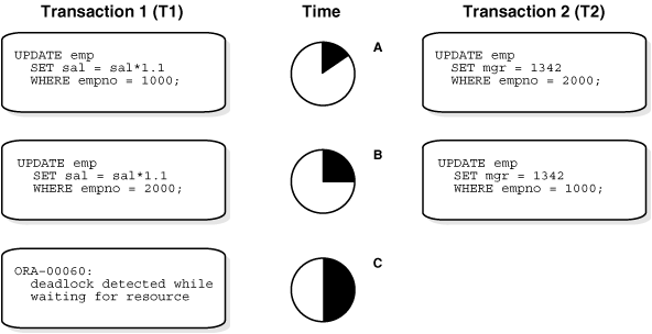

"Table Locks (TM)"A deadlock can occur when two or more users are waiting for data locked by each other. Deadlocks prevent some transactions from continuing to work. Figure 13-3 is a hypothetical illustration of two transactions in a deadlock.
In Figure 13-3, no problem exists at time point A, as each transaction has a row lock on the row it attempts to update. Each transaction proceeds without being terminated. However, each tries next to update the row currently held by the other transaction. Therefore, a deadlock results at time point B, because neither transaction can obtain the resource it needs to proceed or terminate. It is a deadlock because no matter how long each transaction waits, the conflicting locks are held.
Figure 13-3 Two Transactions in a Deadlock
Oracle automatically detects deadlock situations and resolves them by rolling back one of the statements involved in the deadlock, thereby releasing one set of the conflicting row locks. A corresponding message also is returned to the transaction that undergoes statement-level rollback. The statement rolled back is the one belonging to the transaction that detects the deadlock. Usually, the signalled transaction should be rolled back explicitly, but it can retry the rolled-back statement after waiting.
