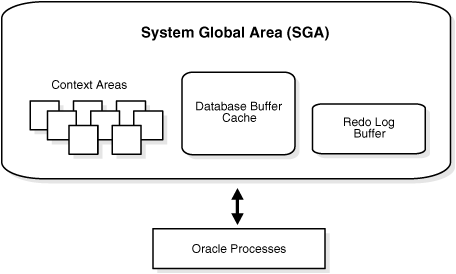

Every running Oracle database is associated with an Oracle instance. When a database is started on a database server (regardless of the type of computer), Oracle allocates a memory area called the System Global Area (SGA) and starts one or more Oracle processes. This combination of the SGA and the Oracle processes is called an Oracle instance. The memory and processes of an instance manage the associated database's data efficiently and serve the one or multiple users of the database.
Figure 12-1 shows an Oracle instance.
After starting an instance, Oracle associates the instance with the specified database. This is a mounted database. The database is then ready to be opened, which makes it accessible to authorized users.
