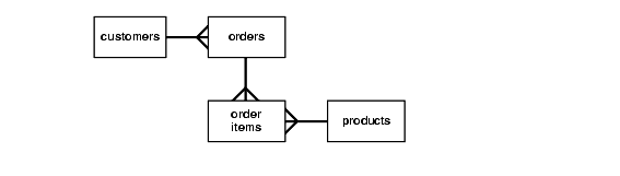

Although this guide primarily uses star schemas in its examples, you can also use the third normal form for your data warehouse implementation.
Third normal form modeling is a classical relational-database modeling technique that minimizes data redundancy through normalization. When compared to a star schema, a 3NF schema typically has a larger number of tables due to this normalization process. For example, in Figure 19-1, orders
and order
items
tables contain similar information as sales
table in the star schema in Figure 19-2.
3NF schemas are typically chosen for large data warehouses, especially environments with significant data-loading requirements that are used to feed data marts and execute long-running queries.
The main advantages of 3NF schemas are that they:
Provide a neutral schema design, independent of any application or data-usage considerations
May require less data-transformation than more normalized schemas such as star schemas
Figure 19-1 presents a graphical representation of a third normal form schema.
Queries on 3NF schemas are often very complex and involve a large number of tables. The performance of joins between large tables is thus a primary consideration when using 3NF schemas.
One particularly important feature for 3NF schemas is partition-wise joins. The largest tables in a 3NF schema should be partitioned to enable partition-wise joins. The most common partitioning technique in these environments is composite range-hash partitioning for the largest tables, with the most-common join key chosen as the hash-partitioning key.
Parallelism is often heavily utilized in 3NF environments, and parallelism should typically be enabled in these environments.

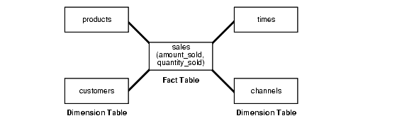

The star schema is perhaps the simplest data warehouse schema. It is called a star schema because the entity-relationship diagram of this schema resembles a star, with points radiating from a central table. The center of the star consists of a large fact table and the points of the star are the dimension tables.
A star query is a join between a fact table and a number of dimension tables. Each dimension table is joined to the fact table using a primary key to foreign key join, but the dimension tables are not joined to each other. The optimizer recognizes star queries and generates efficient execution plans for them.
A typical fact table contains keys and measures. For example, in the sh
sample schema, the fact table, sales
, contain the measures quantity_sold
, amount
, and cost
, and the keys cust_id
, time_id
, prod_id
, channel_id
, and promo_id
. The dimension tables are customers
, times
, products
, channels
, and promotions
. The products
dimension table, for example, contains information about each product number that appears in the fact table.
A star join is a primary key to foreign key join of the dimension tables to a fact table.
The main advantages of star schemas are that they:
Provide a direct and intuitive mapping between the business entities being analyzed by end users and the schema design.
Provide highly optimized performance for typical star queries.
Are widely supported by a large number of business intelligence tools, which may anticipate or even require that the data warehouse schema contain dimension tables.
Star schemas are used for both simple data marts and very large data warehouses.
Figure 19-2 presents a graphical representation of a star schema.

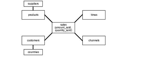

The snowflake schema is a more complex data warehouse model than a star schema, and is a type of star schema. It is called a snowflake schema because the diagram of the schema resembles a snowflake.
Snowflake schemas normalize dimensions to eliminate redundancy. That is, the dimension data has been grouped into multiple tables instead of one large table. For example, a product dimension table in a star schema might be normalized into a products table, a product_category
table, and a product_manufacturer
table in a snowflake schema. While this saves space, it increases the number of dimension tables and requires more foreign key joins. The result is more complex queries and reduced query performance. Figure 19-3 presents a graphical representation of a snowflake schema.
Oracle recommends you choose a star schema over a snowflake schema unless you have a clear reason not to.You should consider the following when using star queries:
