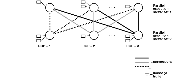

To execute a query in parallel, Oracle generally creates a producer queue server and a consumer server. The producer queue server retrieves rows from tables and the consumer server performs operations such as join, sort, DML, and DDL on these rows. Each server in the producer execution process set has a connection to each server in the consumer set. This means that the number of virtual connections between parallel execution servers increases as the square of the DOP.
Each communication channel has at least one, and sometimes up to four memory buffers. Multiple memory buffers facilitate asynchronous communication among the parallel execution servers.
A single-instance environment uses at most three buffers for each communication channel. An Oracle Real Application Clusters environment uses at most four buffers for each channel. Figure 25-1 illustrates message buffers and how producer parallel execution servers connect to consumer parallel execution servers.
Figure 25-1 Parallel Execution Server Connections and Buffers

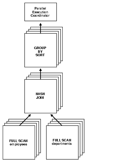

As an example of parallel query with intra- and inter-operation parallelism, consider the following, more complex query:
SELECT /*+ PARALLEL(employees 4) PARALLEL(departments 4) USE_HASH(employees) ORDERED */ MAX(salary), AVG(salary) FROM employees, departments WHERE employees.department_id = departments.department_id GROUP BY employees.department_id;
Note that hints have been used in the query to force the join order and join method, and to specify the DOP of the tables employees
and departments
. In general, you should let the optimizer determine the order and method.
Figure 25-2 illustrates the data flow graph or query plan for this query.
Figure 25-2 Data Flow Diagram for Joining Tables
Given two sets of parallel execution servers SS1 and SS2 for the query plan illustrated in Figure 25-2, the execution will proceed as follows: each server set (SS1 and SS2) will have four execution processes because of the PARALLEL
hint in the query that specifies the DOP. In other words, the DOP will be four because each set of parallel execution servers will have four processes.
Slave set SS1 first scans the table employees
while SS2 will fetch rows from SS1 and build a hash table on the rows. In other words, the parent servers in SS2 and the child servers in SS2 work concurrently: one in scanning employees
in parallel, the other in consuming rows sent to it from SS1 and building the hash table for the hash join in parallel. This is an example of inter-operation parallelism.
After SS1 has finished scanning the entire table employees
(that is, all granules or task units for employees
are exhausted), it scans the table departments
in parallel. It sends its rows to servers in SS2, which then perform the probes to finish the hash-join in parallel. After SS1 is done scanning the table departments
in parallel and sending the rows to SS2, it switches to performing the GROUP
BY
in parallel. This is how two server sets run concurrently to achieve inter-operation parallelism across various operators in the query tree while achieving intra-operation parallelism in executing each operation in parallel.
Another important aspect of parallel execution is the re-partitioning of rows while they are sent from servers in one server set to another. For the query plan in Figure 25-2, after a server process in SS1 scans a row of employees
, which server process of SS2 should it send it to? The partitioning of rows flowing up the query tree is decided by the operator into which the rows are flowing into. In this case, the partitioning of rows flowing up from SS1 performing the parallel scan of employees
into SS2 performing the parallel hash-join is done by hash partitioning on the join column value. That is, a server process scanning employees
computes a hash function of the value of the column employees.employee_id
to decide the number of the server process in SS2 to send it to. The partitioning method used in parallel queries is explicitly shown in the EXPLAIN
PLAN
of the query. Note that the partitioning of rows being sent between sets of execution servers should not be confused with Oracle's partitioning feature whereby tables can be partitioned using hash, range, and other methods.
Operations that require the output of other operations are known as consumer operations. In Figure 25-2, the GROUP
BY
SORT
operation is the producer of the HASH
JOIN
operation because GROUP
BY
SORT
requires the HASH
JOIN
output.
Producer operations can begin consuming rows as soon as the producer operations have produced rows. In the previous example, while the parallel execution servers are producing rows in the FULL
SCAN
departments
operation, another set of parallel execution servers can begin to perform the HASH
JOIN
operation to consume the rows.
Each of the two operations performed concurrently is given its own set of parallel execution servers. Therefore, both query operations and the data flow tree itself have parallelism. The parallelism of an individual operation is called intraoperation parallelism and the parallelism between operations in a data flow tree is called interoperation parallelism. Due to the producer-consumer nature of the Oracle server's operations, only two operations in a given tree need to be performed simultaneously to minimize execution time. To illustrate intraoperation and interoperation parallelism, consider the following statement:

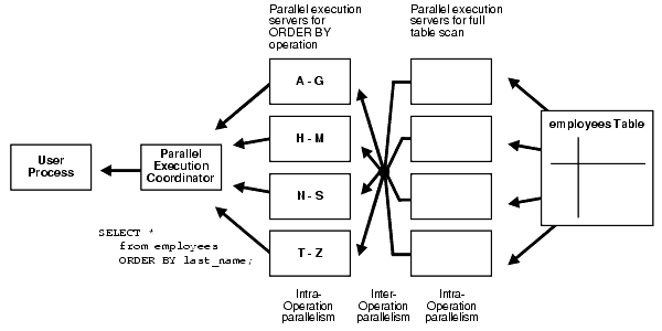

SELECT * FROM employees ORDER BY last_name;
The execution plan implements a full scan of the employees
table. This operation is followed by a sorting of the retrieved rows, based on the value of the last_name
column. For the sake of this example, assume the last_name
column is not indexed. Also assume that the DOP for the query is set to 4, which means that four parallel execution servers can be active for any given operation.
Figure 25-3 illustrates the parallel execution of the example query.
Figure 25-3 Interoperation Parallelism and Dynamic Partitioning
As you can see from Figure 25-3, there are actually eight parallel execution servers involved in the query even though the DOP is 4. This is because a parent and child operator can be performed at the same time (interoperation parallelism).
Also note that all of the parallel execution servers involved in the scan operation send rows to the appropriate parallel execution server performing the SORT
operation. If a row scanned by a parallel execution server contains a value for the last_name
column between A
and G
, that row gets sent to the first ORDER
BY
parallel execution server. When the scan operation is complete, the sorting processes can return the sorted results to the coordinator, which, in turn, returns the complete query results to the user.

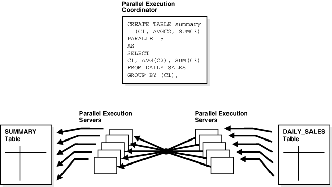

For performance reasons, decision support applications often require large amounts of data to be summarized or rolled up into smaller tables for use with ad hoc, decision support queries. Rollup occurs regularly (such as nightly or weekly) during a short period of system inactively.
Parallel execution lets you parallelize the query and create operations of creating a table as a subquery from another table or set of tables.
Clustered tables cannot be created and populated in parallel.
Figure 25-4 illustrates creating a table from a subquery in parallel.
Figure 25-4 Creating a Summary Table in Parallel

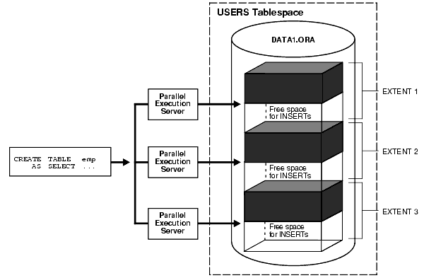

When you create indexes and tables in parallel, each parallel execution server allocates a new extent and fills the extent with the table or index data. Thus, if you create an index with a DOP of 3, the index will have at least three extents initially. Allocation of extents is the same for rebuilding indexes in parallel and for moving, splitting, or rebuilding partitions in parallel.
Serial operations require the schema object to have at least one extent. Parallel creations require that tables or indexes have at least as many extents as there are parallel execution servers creating the schema object.
When you create a table or index in parallel, it is possible to create pockets of free space—either external or internal fragmentation. This occurs when the temporary segments used by the parallel execution servers are larger than what is needed to store the rows.
If the unused space in each temporary segment is larger than the value of the MINIMUM
EXTENT
parameter set at the tablespace level, then Oracle trims the unused space when merging rows from all of the temporary segments into the table or index. The unused space is returned to the system free space and can be allocated for new extents, but it cannot be coalesced into a larger segment because it is not contiguous space (external fragmentation).
If the unused space in each temporary segment is smaller than the value of the MINIMUM
EXTENT
parameter, then unused space cannot be trimmed when the rows in the temporary segments are merged. This unused space is not returned to the system free space; it becomes part of the table or index (internal fragmentation) and is available only for subsequent inserts or for updates that require additional space.
For example, if you specify a DOP of 3 for a CREATE
TABLE
... AS
SELECT
statement, but there is only one datafile in the tablespace, then internal fragmentation may occur, as shown in Figure 25-5. The pockets of free space within the internal table extents of a datafile cannot be coalesced with other free space and cannot be allocated as extents.
See Oracle Database Performance Tuning Guide for more information about creating tables and indexes in parallel.
Figure 25-5 Unusable Free Space (Internal Fragmentation)

The CREATE
TABLE
... AS
SELECT
statement contains two parts: a CREATE
part (DDL) and a SELECT
part (query). Oracle can parallelize both parts of the statement. The CREATE
part follows the same rules as other DDL operations.
The query part of a CREATE
TABLE
... AS
SELECT
statement can be parallelized only if the following conditions are satisfied:
The query includes a parallel hint specification (PARALLEL
or PARALLEL_INDEX
) or the CREATE
part of the statement has a PARALLEL
clause specification or the schema objects referred to in the query have a PARALLEL
declaration associated with them.
At least one of the tables specified in the query requires one of the following: a full table scan or an index range scan spanning multiple partitions.
The DOP for the query part of a CREATE
TABLE
... AS
SELECT
statement is determined by one of the following rules:
The query part uses the values specified in the PARALLEL
clause of the CREATE
part.
If the PARALLEL
clause is not specified, the default DOP is the number of CPUs.
If the CREATE
is serial, then the DOP is determined by the query.
Note that any values specified in a hint for parallelism are ignored.
The CREATE
operation of CREATE
TABLE
... AS
SELECT
can be parallelized only by a PARALLEL
clause or an ALTER
SESSION
FORCE
PARALLEL
DDL
statement.
When the CREATE
operation of CREATE
TABLE
... AS
SELECT
is parallelized, Oracle also parallelizes the scan operation if possible. The scan operation cannot be parallelized if, for example:
The SELECT
clause has a NO_PARALLEL
hint
The operation scans an index of a nonpartitioned table
When the CREATE
operation is not parallelized, the SELECT
can be parallelized if it has a PARALLEL
hint or if the selected table (or partitioned index) has a parallel declaration.
The DOP for the CREATE
operation, and for the SELECT
operation if it is parallelized, is specified by the PARALLEL
statement, unless it is overridden by an ALTER
SESSION
FORCE
PARALLEL
DDL
statement. If the PARALLEL
clause does not specify the DOP, the default is the number of CPUs.

After you determine the initial setting for the shared pool, you must calculate additional memory requirements for message buffers and determine how much additional space you need for cursors.
You must increase the value for the SHARED_POOL_SIZE
parameter to accommodate message buffers. The message buffers allow query server processes to communicate with each other.
Oracle uses a fixed number of buffers for each virtual connection between producer query servers and consumer query servers. Connections increase as the square of the DOP increases. For this reason, the maximum amount of memory used by parallel execution is bound by the highest DOP allowed on your system. You can control this value by using either the PARALLEL_MAX_SERVERS
parameter or by using policies and profiles.
To calculate the amount of memory required, use one of the following formulas:
For SMP systems:
mem in bytes = (3 x size x users x groups x connections)
For SMP Real Application Clusters and MPP systems:
mem in bytes = ((3 x local) + (2 x remote)) x (size x users x groups) / instances
Each instance uses the memory computed by the formula.
The terms are:
SIZE
= PARALLEL_EXECUTION_MESSAGE_SIZE
USERS
= the number of concurrent parallel execution users that you expect to have running with the optimal DOP
GROUPS
= the number of query server process groups used for each query
A simple SQL statement requires only one group. However, if your queries involve subqueries which will be processed in parallel, then Oracle uses an additional group of query server processes.
CONNECTIONS
= (DOP2 + 2 x DOP)
If your system is a cluster or MPP, then you should account for the number of instances because this will increase the DOP. In other words, using a DOP of 4 on a two instance cluster results in a DOP of 8. A value of PARALLEL_MAX_SERVERS
times the number of instances divided by four is a conservative estimate to use as a starting point.
LOCAL
= CONNECTIONS
/INSTANCES
REMOTE
= CONNECTIONS
- LOCAL
Add this amount to your original setting for the shared pool. However, before setting a value for either of these memory structures, you must also consider additional memory for cursors, as explained in the following section.

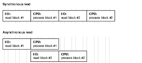

These parameters enable or disable the operating system's asynchronous I/O facility. They allow query server processes to overlap I/O requests with processing when performing table scans. If the operating system supports asynchronous I/O, leave these parameters at the default value of TRUE
. Figure 25-6 illustrates how asynchronous read works.
Asynchronous operations are currently supported for parallel table scans, hash joins, sorts, and serial table scans. However, this feature can require operating system specific configuration and may not be supported on all platforms. See Oracle Database Installation Guide for more information.

You can increase the optimizer's ability to generate parallel plans converting subqueries, especially correlated subqueries, into joins. Oracle can parallelize joins more efficiently than subqueries. This also applies to updates. See "Updating the Table in Parallel" for more information.
Oracle cannot return results to a user process in parallel. If a query returns a large number of rows, execution of the query might indeed be faster. However, the user process can only receive the rows serially. To optimize parallel execution performance for queries that retrieve large result sets, use PARALLEL
CREATE
TABLE
... AS
SELECT
or direct-path INSERT
to store the result set in the database. At a later time, users can view the result set serially.
Performing the SELECT
in parallel does not influence the CREATE
statement. If the CREATE
is parallel, however, the optimizer tries to make the SELECT
run in parallel also.
When combined with the NOLOGGING
option, the parallel version of CREATE
TABLE
... AS
SELECT
provides a very efficient intermediate table facility, for example:
CREATE TABLE summary PARALLEL NOLOGGING AS SELECT dim_1, dim_2 ..., SUM (meas_1) FROM facts GROUP BY dim_1, dim_2;
