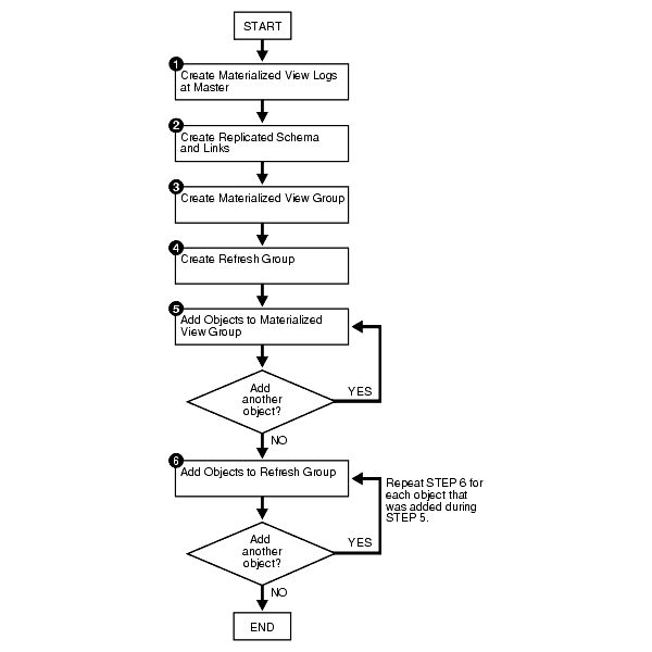

Complete the following steps to create these two materialized view groups.

Step 1 Create materialized view logs at the master site.

Step 3 Create the materialized view group.

Step 4 Create the refresh group.

Step 5 Add objects to the materialized view group.

Step 6 Add objects to the refresh group.
