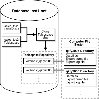

Figure 16-1 provides an overview of the tablespace repository created in this example:
Figure 16-1 Example Tablespace Repository

Clone the tablespace set and add the first version of the tablespace set to the tablespace repository:
DECLARE
tbs_set DBMS_STREAMS_TABLESPACE_ADM.TABLESPACE_SET;
BEGIN
tbs_set(1) := 'sales_tbs1';
tbs_set(2) := 'sales_tbs2';
DBMS_STREAMS_TABLESPACE_ADM.CLONE_TABLESPACES(
tablespace_names => tbs_set,
tablespace_directory_object => 'q1fy2005',
file_group_name => 'strmadmin.sales',
version_name => 'v_q1fy2005');
END;
The sales file group is created automatically if it does not exist.

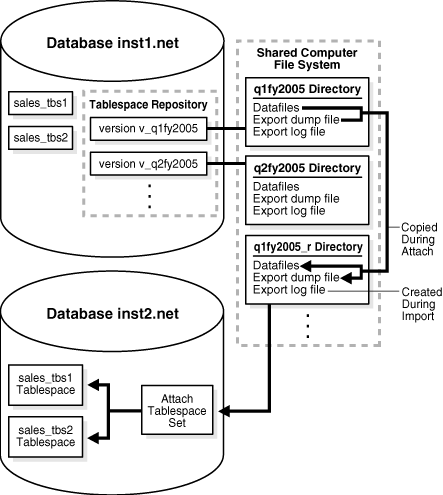

Figure 16-2 provides an overview of how tablespaces in a tablespace repository are attached to a different database in this example:
Figure 16-2 Attaching Tablespaces with a Shared File System

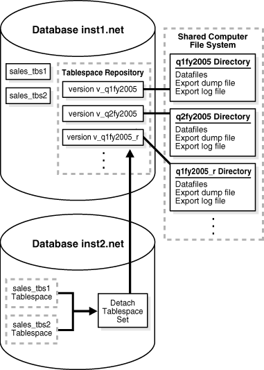

Figure 16-3 provides an overview of how tablespaces are detached and placed in a tablespace repository in this example:
Figure 16-3 Detaching Tablespaces with a Shared File System

Notice that q1fy2005_r is specified for the datafiles_directory_object parameter. Therefore, the datafiles for the tablespaces and the export dump file are copied from the /home/sales/q1fy2005 location to the /home/sales/q1fy2005_r location by the procedure. The attached tablespaces in the inst2.net database use the datafiles in the /home/sales/q1fy2005_r location. The Data Pump import log file also is placed in this directory.
The attached tablespaces use the datafiles in the /home/sales/q1fy2005_r location. However, the v_q1fy2005 version of the tablespaces in the tablespace repository consists of the files in the original /home/sales/q1fy2005 location.

Only one version of a tablespace set can be attached to a database at a time. Therefore, the version of the sales tablespaces for the first quarter of 2005 must be detached from inst2.net before the version of this tablespace set for the second quarter of 2005 can be attached.
Also, notice that the specified export_directory_object is q1fy2005_r, and that the version_name is v_q1fy2005_r. After the detach operation, there are two versions of the tablespace files for the first quarter of 2005 stored in the tablespace repository on inst1.net: one version of the tablespace prior to reporting and one version after reporting. These two versions have different version names and are stored in different directory objects.

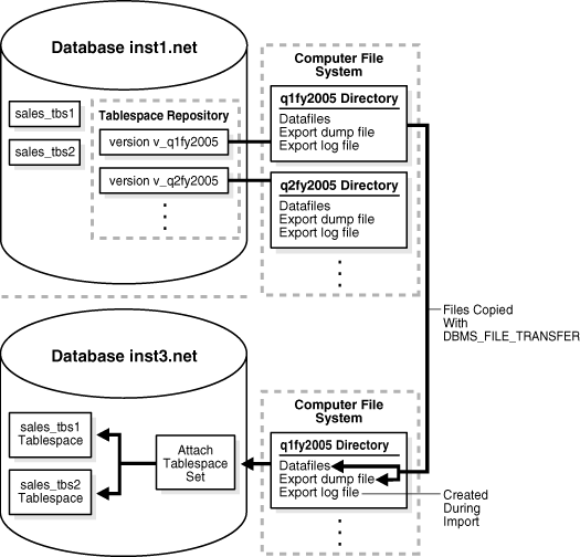

This example runs reports at inst3.net on specific versions of the sales tablespaces stored in a tablespace repository at inst1.net. These two databases do not share a file system, and the reports that are run on inst3.net do not make any changes to the tablespace. Therefore, the tablespaces remain read-only at inst3.net, and, when the reports are complete, there is no need for a new version of the tablespace files in the tablespace repository on inst1.net.
Figure 16-4 provides an overview of how tablespaces in a tablespace repository are attached to a different database in this example:
Figure 16-4 Attaching Tablespaces Without a Shared File System

CREATE DATABASE LINK inst3.net CONNECT TO strmadmin IDENTIFIED BY strmadminpw USING 'inst3.net';
This database link will be used to transfer files to the inst3.net database in Step 6.
Copy the datafile for each tablespace and the export dump file for the first quarter to the inst3.net database:

Connect to inst3.net and attach the tablespace set for the first quarter of 2005 to the inst3.net database from the sales file group in the inst1.net database:
CONNECT strmadmin/strmadminpw@inst3.net

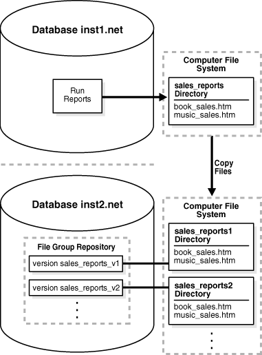

The DBMS_FILE_GROUP package can create a file group repository, add versioned file groups to the repository, and copy versioned file groups from the repository. This section illustrates how to use a file group repository with a scenario that stores reports in the repository.
In this scenario, a business sells books and music over the internet. The business runs weekly reports on the sales data in the inst1.net database and stores these reports in two HTML files on a computer file system. The book_sales.htm file contains the report for book sales, and the music_sales.htm file contains the report for music sales. The business wants to store these weekly reports in a file group repository at the inst2.net remote database. Every week, the two reports are generated on the inst1.net database, transferred to the computer system running the inst2.net database, and added to the repository as a file group version. The file group repository stores all of the file group versions that contain the reports for each week.
Figure 16-5 provides an overview of the file group repository created in this example:
Figure 16-5 Example File Group Repository
The benefits of the file group repository are that it stores metadata about each file group version in the data dictionary and provides a standard interface for managing the file group versions. For example, when the business needs to view a specific sales report, it can query the data dictionary in the inst2.net database to determine the location of the report on the computer file system.

Run the reports on the inst1.net database. Running the reports should place the book_sales.htm and music_sales.htm files in the directory specified in Step 4.
Transfer the report files from the computer system running the inst1.net database to the computer system running the inst2.net database using file transfer protocol (FTP) or some other method. Make sure the files are copied to the directory that corresponds to the directory object created in Step 2.

At the end of the next week, run the reports on the inst1.net database. Running the reports should place new book_sales.htm and music_sales.htm files in the directory specified in Step 4. If necessary, remove the old files from this directory before running the reports.
Transfer the report files from the computer system running the inst1.net database to the computer system running the inst2.net database using file transfer protocol (FTP) or some other method. Make sure the files are copied to the directory that corresponds to the directory object created in Step 12.
