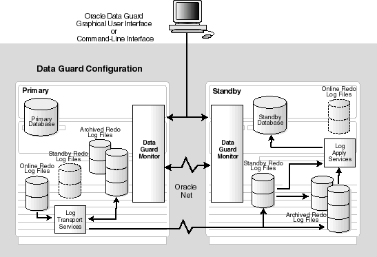

Figure 3-1 shows a two-database broker configuration with the DMON process running at each location and communicating over Oracle Net.
On the primary database, the figure shows the redo transport services in addition to the following main components: the primary database, DMON, the online redo log files, and the archived redo log files. The figure also shows standby redo log files in outline form on the primary side; the standby redo logs are outlined to indicate they are currently inactive but have been configured in preparation for a switchover to the standby role.The standby database includes the following components: a standby database, log apply services, DMON, archived redo log files, and standby redo log files. The online redo log files on the standby database are outlined to indicate they are currently inactive but have been configured in preparation for a switchover to the primary role.

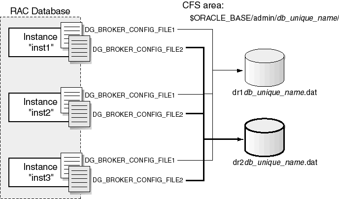

If cluster file system (CFS) is available, and the configuration files reside there, the DG_BROKER_CONFIG_FILEn parameters on all of the instances must be set to these files including the path to the CFS area. Figure 3-2 shows the set up for the broker configuration files on CFS. In this scenario, the parameters and value for all instances would be:
DG_BROKER_CONFIG_FILE1=$ORACLE_BASE/admin/db_unique_name/dr1db_unique_name.dat DG_BROKER_CONFIG_FILE2=$ORACLE_BASE/admin/db_unique_name/dr2db_unique_name.dat
Figure 3-2 Broker Configuration Setup in a CFS Area

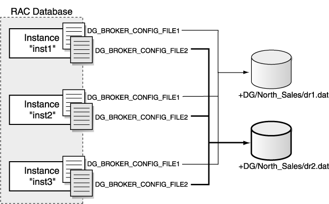

The broker's configuration files can also reside on an ASM disk group. Figure 3-3 shows the setup for the broker configuration files on ASM devices. In this scenario, the parameters and values would be specified, as follows:
ALTER SYSTEM SET DG_BROKER_CONFIG_FILE1 = '+DG/DIRECTORY/DR1.DAT' SCOPE=BOTH; ALTER SYSTEM SET DG_BROKER_CONFIG_FILE2 = '+DG/DIRECTORY/DR2.DAT' SCOPE=BOTH;
Figure 3-3 Broker Configuration Setup with ASM

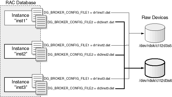

If CFS is not available and you are not using ASM, the files must be on raw devices. In this case, the parameter values on each of the instances must point to the raw devices. Figure 3-4 shows the set up for the broker configuration files on raw devices. On a UNIX system, you would set this up similar to the following on each node:
%ln -s /dev/rdsk/c1t2d3s5 dr1/<db_unique_name>.dat %ln -s /dev/rdsk/c1t2d3s6 dr2/<db_unique_name>.dat
Figure 3-4 Broker Configuration Setup with Raw Devices
If the broker configuration files need to be on raw devices, set up two additional raw devices of 1MB each. Set up the value of the DG_BROKER_CONFIG_FILE1 and DG_BROKER_CONFIG_FILE2 parameters to point to the raw devices. A 1MB configuration file will accommodate 10 databases with a total of 45 instances between them.
You may need a larger device if the number of instances for this configuration exceeds 45 instances. You will need 15KB for each additional instance.
