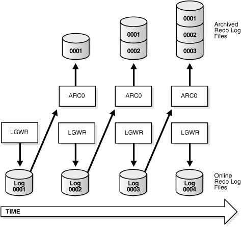

When you run a database in ARCHIVELOG mode, you enable the archiving of the redo log. The database control file indicates that a group of filled redo log files cannot be reused by LGWR until the group is archived. A filled group becomes available for archiving immediately after a redo log switch occurs.
The archiving of filled groups has these advantages:
A database backup, together with online and archived redo log files, guarantees that you can recover all committed transactions in the event of an operating system or disk failure.
If you keep an archived log, you can use a backup taken while the database is open and in normal system use.
You can keep a standby database current with its original database by continuously applying the original archived redo logs to the standby.
You can configure an instance to archive filled redo log files automatically, or you can archive manually. For convenience and efficiency, automatic archiving is usually best. Figure 7-1 illustrates how the archiver process (ARC0 in this illustration) writes filled redo log files to the database archived redo log.
If all databases in a distributed database operate in ARCHIVELOG mode, you can perform coordinated distributed database recovery. However, if any database in a distributed database is in NOARCHIVELOG mode, recovery of a global distributed database (to make all databases consistent) is limited by the last full backup of any database operating in NOARCHIVELOG mode.
Figure 7-1 Redo Log File Use in ARCHIVELOG Mode
