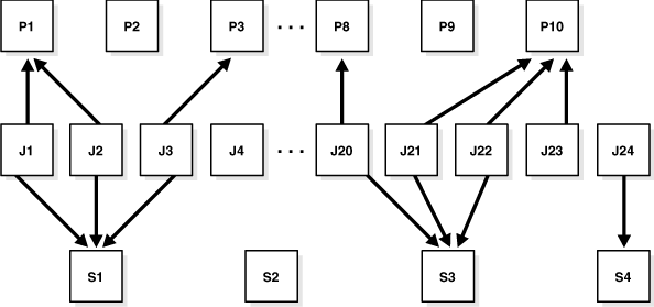

To define what is executed and when, you assign relationships among programs, jobs, and schedules. Figure 26-1 illustrates examples of such relationships.
Figure 26-1 Relationships Among Programs, Jobs, and Schedules
To understand Figure 26-1, consider a situation where tables are being analyzed. In this example, P1
would be a program to analyze a table using the DBMS_STATS
package. The program has an input parameter for the table name. Two jobs, J1
and J2
, both point to the same program, but each supplies a different table name. Additionally, schedule S1
could specify a run time of 2:00 a.m. every day. The end result would be that the two tables named in J1
and J2
are analyzed daily at 2:00 a.m.
Note that J4
points to no other entity, so it is self-contained with all relevant information defined in the job itself. P2
, P9
and S2
illustrate that you can leave a program or schedule unassigned if you want. You could, for example, create a program that calculates a year-end inventory and temporarily leave it unassigned to any job.

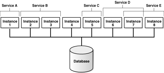

Set service affinity for member jobs
You can set the service
attribute of a job class to a desired database service name. This determines the instances in a Real Application Clusters environment that run the member jobs, and optionally the system resources that are assigned to member jobs. See "Service Affinity when Using the Scheduler" for more information.
Set resource allocation for member jobs
Job classes provide the link between the Database Resource Manager and the Scheduler, because each job class can specify a resource consumer group as an attribute. Member jobs then belong to the specified consumer group, and are assigned resources according to settings in the current resource plan.
Alternatively, you can leave the resource_consumer_group
attribute NULL
and set the service
attribute of a job class to a desired database service name. That service can in turn be mapped to a resource consumer group.
See Chapter 24, "Using the Database Resource Manager" for more information on mapping services to consumer groups.

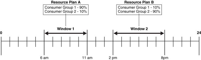

You create windows to change resource allocation among jobs during various time periods of the day, week, and so on. A window is represented by an interval of time with a well-defined beginning and end, such as "from 12am-6am".
Windows work with job classes to control resource allocation. Each window specifies the resource plan to activate when the window opens (becomes active), and each job class specifies a resource consumer group or specifies a database service, which can map to a consumer group. A job that runs within a window therefore has resources allocated to it according to the consumer group of its job class and the resource plan of the window.
Figure 26-2 shows a workday that includes two windows. In this configuration, jobs that belong to the job class that links to Consumer Group 1
get more resources in the morning than in the afternoon. The opposite is true for jobs in the job class that links to Consumer Group 2
Figure 26-2 Windows help define the resources that are allocated to jobs
See Chapter 24, "Using the Database Resource Manager" for more information on resource plans and consumer groups.

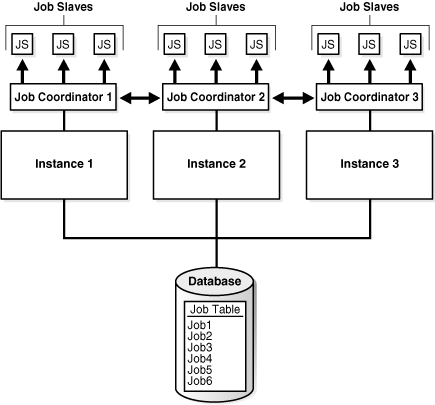

This section discusses the Scheduler's architecture, and describes:
Figure 26-3 illustrates how jobs are handled by the database.
The job table is a container for all the jobs, with one table per database. The job table stores information for all jobs such as the owner name or the level of logging. You can find this information in the *_SCHEDULER_JOBS
views.
Jobs are database objects, and can therefore accumulate and take up too much space. To avoid this, job objects are automatically dropped by default after completion. This behavior is controlled by the auto_drop
job attribute.
See "How to View Scheduler Information" for the available job views and administration.
The job coordinator is a background process (cjqNNN
) that is automatically started when jobs must be run, or windows must be opened. It is automatically brought down after a sustained period of Scheduler inactivity. The job coordinator:
Controls and spawns the job slaves
Queries the job table
Picks up jobs from the job table on a regular basis and places them in a memory cache. This improves performance by avoiding going to the disk
Takes jobs from the memory cache and passes them to job slaves for execution
Cleans up the job slave pool when slaves are no longer needed
Goes to sleep when no jobs are scheduled
Wakes up when a new job is about to be executed or a job was created using the CREATE_JOB
procedure
Upon database startup after an abnormal database shutdown, recovers any jobs that were running.
You do not need to set when the job coordinator checks the job table; the system chooses the time frame automatically.
One job coordinator is used per instance. This is also the case in RAC environments.

In a Real Application Clusters (RAC) environment, the Scheduler uses one job table for each database and one job coordinator for each instance. The job coordinators communicate with each other to keep information current. The Scheduler attempts to balance the load of the jobs of a job class across all available instances when the job class has no service affinity, or across the instances assigned to a particular service when the job class does have service affinity.
Figure 26-4 illustrates a typical RAC architecture, with each instance's job coordinator exchanging information with the others.

The Scheduler enables you to specify the database service under which a job should be run (service affinity). This ensures better availability than instance affinity because it guarantees that other nodes can be dynamically assigned to the service if an instance goes down. Instance affinity does not have this capability, so, when an instance goes down, none of the jobs with an affinity to that instance will be able to run until the instance comes back up. Figure 26-5 illustrates a typical example of how services and instances could be used.
Figure 26-5 Service Affinity and the Scheduler
In Figure 26-5, you could change the properties of the services and the Scheduler will automatically recognize the change.
Each job class can specify a database service. If a service is not specified, the job class belongs to an internal service that is guaranteed to be mapped to every running instance.
