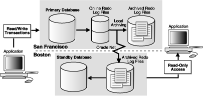

Figure 7-1 shows a two-site Data Guard configuration before the roles of the databases are switched. The primary database is in San Francisco, and the standby database is in Boston.
Figure 7-1 Data Guard Configuration Before Switchover

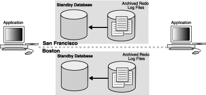

Figure 7-2 shows the Data Guard environment after the original primary database was switched over to a standby database, but before the original standby database has become the new primary database. At this stage, the Data Guard configuration temporarily has two standby databases.
Figure 7-2 Standby Databases Before Switchover to the New Primary Database

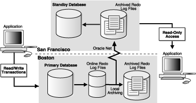

Figure 7-3 shows the Data Guard environment after a switchover took place. The original standby database became the new primary database. The primary database is now in Boston, and the standby database is now in San Francisco.
Figure 7-3 Data Guard Environment After Switchover

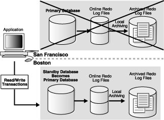

Figure 7-4 shows the result of a failover from a primary database in San Francisco to a physical standby database in Boston.
Figure 7-4 Failover to a Standby Database
