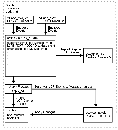

This example illustrates using a single ANYDATA
queue to create an Oracle Streams messaging environment in which message payloads of different types are stored in the same queue. Specifically, this example illustrates the following messaging features of Oracle Streams:
Enqueuing messages containing order payload as ANYDATA
payloads
Enqueuing messages containing customer payload as ANYDATA
payloads
Enqueuing messages containing row LCRs as ANYDATA
payloads
Creating a rule set for applying the events
Creating an evaluation context used by the rule set
Creating an Oracle Streams apply process to dequeue and process the events based on rules
Creating a message handler and associating it with the apply process
Explicitly dequeuing and processing events based on rules without using the apply process
Figure 23-1 provides an overview of this environment.
Figure 23-1 Example Oracle Streams Messaging Environment
