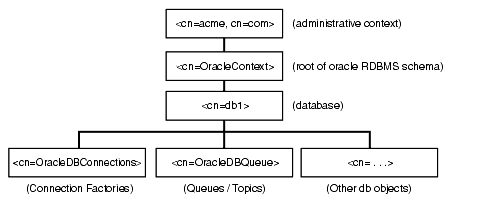

11.1.1.3 Using JNDI to Look Up ConnectionFactory Objects
A JMS administrator can register ConnectionFactory objects in a Lightweight Directory Access Protocol (LDAP) server. The following setup is required to enable Java Naming and Directory Interface (JNDI) lookup in JMS:
  1. Register Database
    When the Oracle Database server is installed, the database must be registered with the LDAP server. This can be accomplished using the Database Configuration Assistant (DBCA). Figure 11-1 shows the structure of Oracle Streams AQ entries in the LDAP server. ConnectionFactory information is stored under <cn=OracleDBConnections>, while topics and queues are stored under <cn=OracleDBQueues>.
    Figure 11-1 Structure of Oracle Streams AQ Entries in LDAP Server
    Description of adque446.gif follows
  2. Set Parameter GLOBAL_TOPIC_ENABLED.
    The GLOBAL_TOPIC_ENABLED system parameter for the database must be set to TRUE. This ensures that all queues and topics created in Oracle Streams AQ are automatically registered with the LDAP server. This parameter can be set by using ALTER SYSTEM SET GLOBAL_TOPIC_ENABLED = TRUE.
  3. Register ConnectionFactory Objects
    After the database has been set up to use an LDAP server, the JMS administrator can register ConnectionFactory, QueueConnectionFactory, and TopicConnectionFactory objects in LDAP by using AQjmsFactory.registerConnectionFactory().
