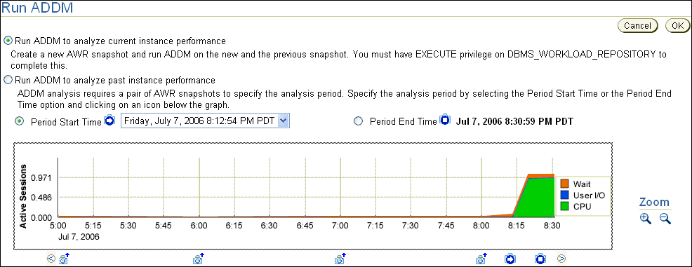

In this example, CPU usage spiked in the last 10 minutes.
Select Run ADDM to analyze current instance performance and click OK.

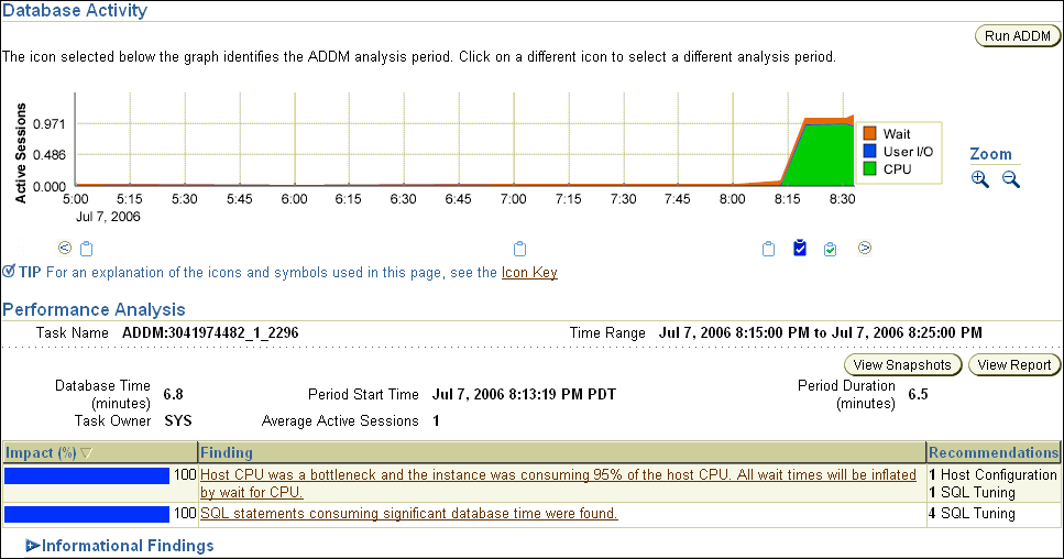

After ADDM completes the analysis, the Automatic Database Diagnostic Monitor (ADDM) page appears with the results of the ADDM run, as shown on Figure 6-1.

Figure 6-1 Analyzing Current Database Performance

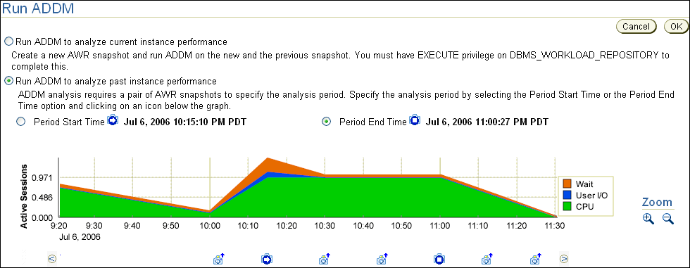

Select Run ADDM to analyze past instance performance.
Specify a time period for analysis by selecting a pair of AWR snapshots.
To select snapshots:
Select Period Start Time.
Below the graph for the starting snapshot, click the snapshot you want to use for the start time.
A play icon (displayed as an arrow) appears over the snapshot icon. In this example, database activity peaked from 10:15 p.m. to 11:00 p.m., so the snapshot taken at 10:15 p.m. is selected for the start time.
Select Period End Time.
Below the graph for the ending snapshot, click the snapshot you want to use for the end time.
A stop icon (displayed as a square) appears over the snapshot icon. In this example, the snapshot taken at 11:00 p.m. is selected.
Click OK.

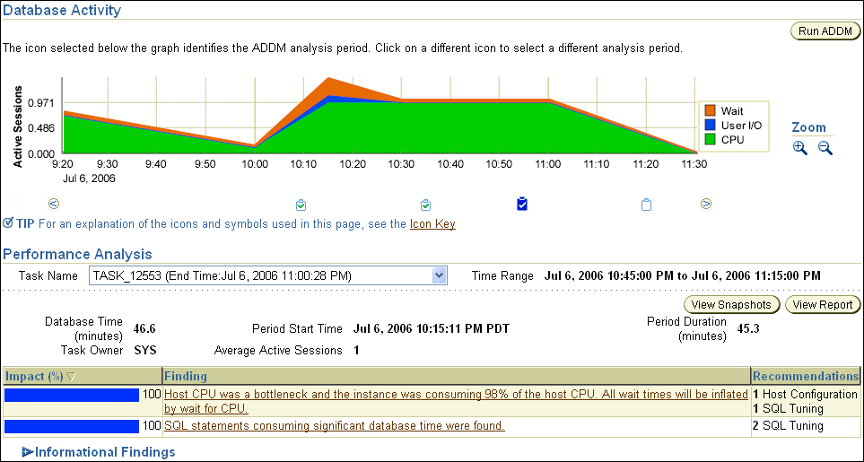

After ADDM completes the analysis, the Automatic Database Diagnostic Monitor (ADDM) page appears with the results of the ADDM run, as shown on Figure 6-2.

Figure 6-2 Analyzing Historical Database Performance

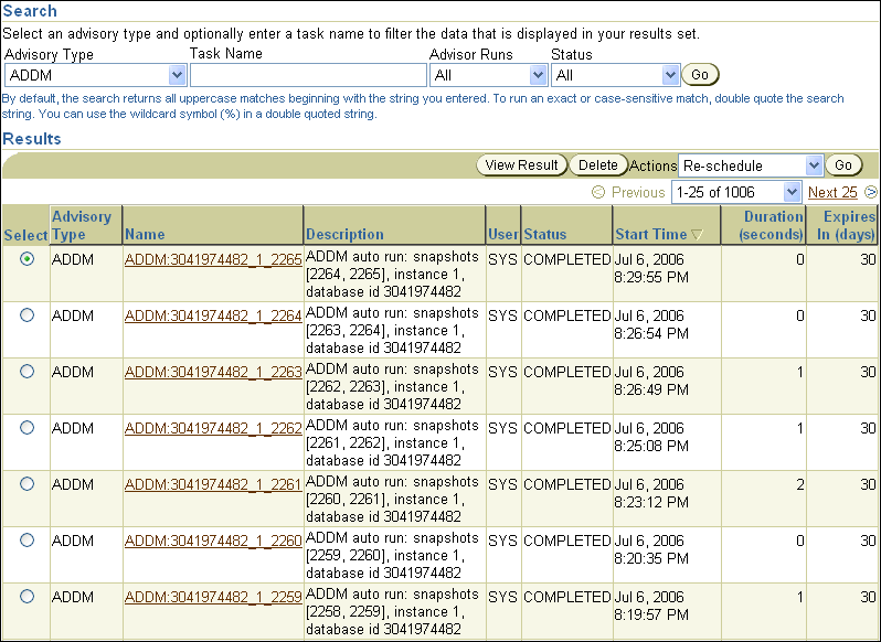

Under Advisor Tasks, select ADDM for Advisory Type and the appropriate search criteria and click Go.
For example, you may want to select All for Advisor Runs to view all ADDM tasks.
The ADDM tasks are displayed under Results. To view an ADDM result, select the desired ADDM task and click View Result.
