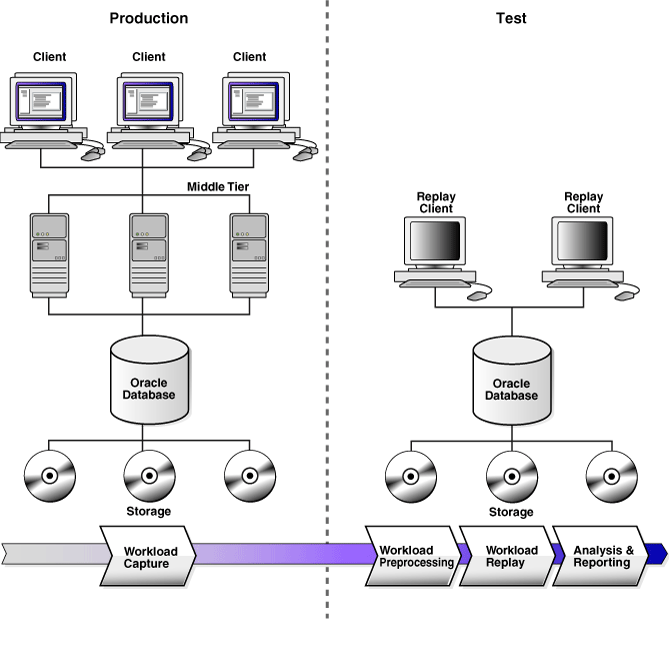

By capturing a workload on the production system and replaying it on a test system, Database Replay enables you to realistically test system changes by essentially recreating the production workload environment on a test system.
Using Database Replay requires four main steps, as shown in Figure 1-1:
Only workload capture is currently supported in this release. Captured workloads can be preprocessed and replayed on Oracle Database 11g Release 1 (11.1) and subsequent releases.The first step in using Database Replay is to capture the production workload. Capturing a workload involves recording all requests made by external clients to Oracle Database. When workload capture is enabled, all external client requests directed to Oracle Database are tracked and stored in binary files, called capture files, on the file system. These capture files are platform independent and can be transported to another system. You can specify the start time and duration for the workload capture, as well as the location to store the capture files. Once workload capture begins, all external database calls are written to the capture files. The capture files contain all relevant information about the client request, such as SQL text, bind values, and transaction information. Background activities and database scheduler jobs are not captured.
For information about how to capture a workload on the production system, see "Capturing a Database Workload".
Once the workload has been captured, the information in the capture files need to be preprocessed. Preprocessing creates all necessary metadata needed for replaying the workload. This must be done once for every captured workload before they can be replayed. After the captured workload is preprocessed, it can be replayed repeatedly on a replay system running the same version of Oracle Database. Typically, the capture files should be copied to another system for preprocessing. As workload preprocessing can be time consuming and resource intensive, it is recommended that this step be performed on the test system where the workload will be replayed.

Database Replay uses a client program called the replay client to recreate all external client requests recorded during workload capture. Depending on the captured workload, you may need one or more replay clients to properly replay the workload. A calibration tool is provided to help determine the number of replay clients needed for a particular workload. Because the entire workload is replayed, including DML and SQL queries, the data in the replay system should be logically similar to the data in the capture system to minimize data divergence and enable reliable analysis of the replay.
