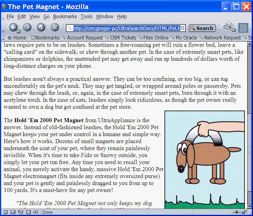

Figure 5-1 shows an original document to which we can apply highlighting, gisting, and theme extraction in the following sections.
Figure 5-1 Sample Document for Highlighting, Gisting, and Theme Extraction

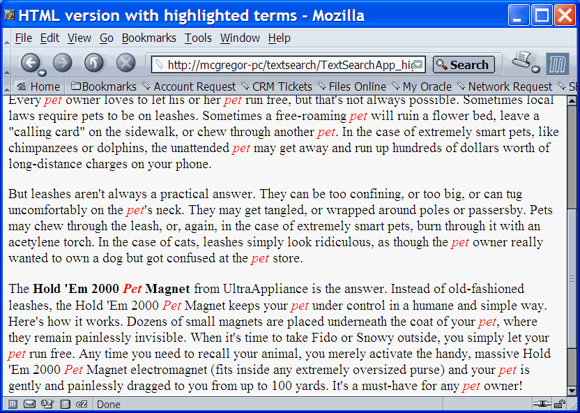

Figure 5-2 is a screen shot of a query application presenting the document shown in Figure 5-1 with the query term pet highlighted. This output was created using the text query application produced by a wizard described in Appendix A, "CONTEXT Query Application".

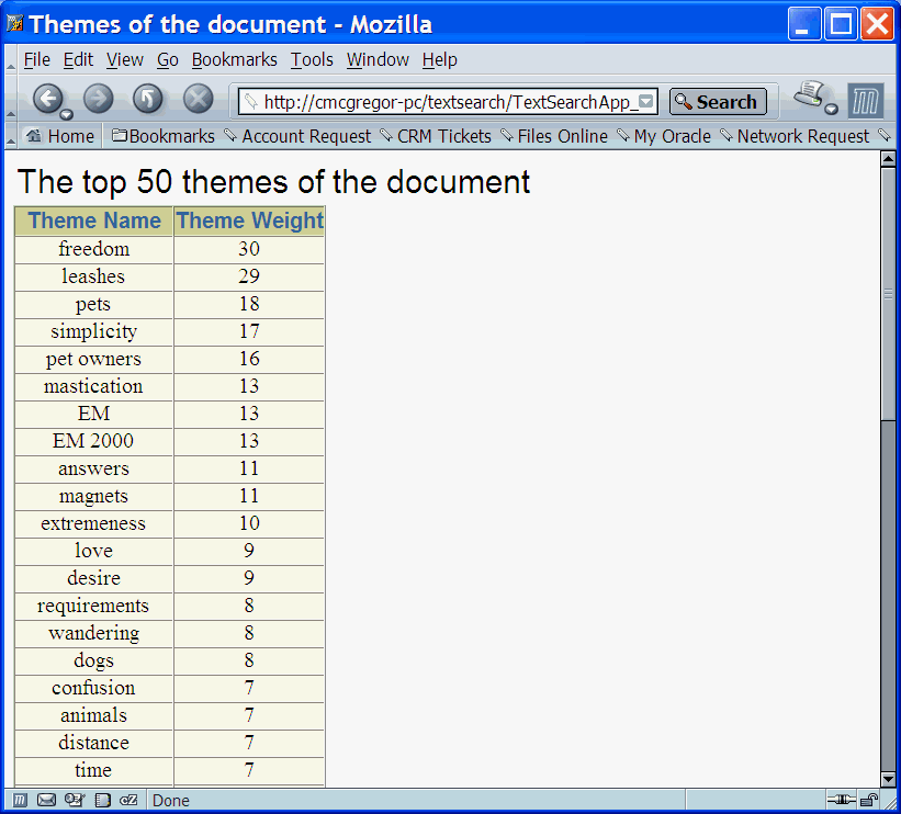

Figure 5-3 is a screen shot of a query application presenting a list of themes for the document shown in Figure 5-1. This output was created using the text query application produced by a wizard described in Appendix A, "CONTEXT Query Application".
Figure 5-3 Query Application Displaying Document Themes

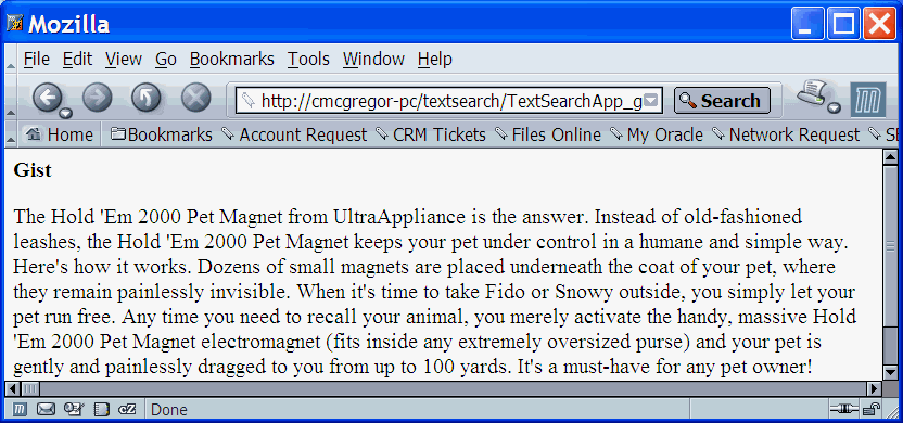

Figure 5-4 is a screen shot of a query application presenting a gist of the document shown in Figure 5-1. This output was created using the text query application produced by a wizard described in Appendix A, "CONTEXT Query Application".
