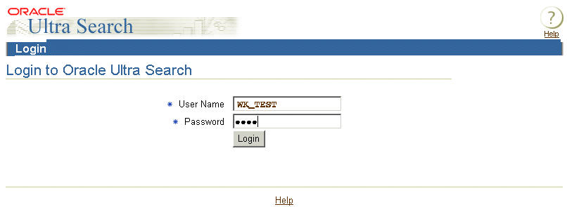

Log on to Oracle Ultra Search using the Oracle Ultra Search Administration Tool screen.
In your Web browser, enter the domain and port of the computer where you have Oracle Ultra Search installed, followed by /ultrasearch/admin/index.jsp
http://your_computer.domain:http_port/ultrasearch/admin/index.jsp
For example:
http://comp1.ultrasupply.com:7778/ultrasearch/admin/index.jsp
Enter your user name and password to log in to Oracle Ultra Search. For example:
Login: WK_TEST
Password: WK_TEST
The login screen is displayed in Figure 2-1.

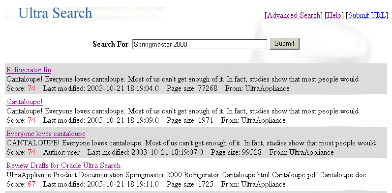

This section describes the steps taken by you as the Ultra Appliance call center agent, using Oracle Ultra Search to query the company intranet and database. You can query the Ultra Appliance information sources after you have permitted Oracle Ultra Search to crawl and index the Ultra Appliance intranet and database.
To query the Ultra Appliance intranet:
Enter the URL for the Oracle Ultra Search location. For example:
http://your_computer.com:http_port/ultrasearch/query/search.jsp
Enter Springmaster 2000 in the Search For field.
You should refer to the output displayed in Figure 2-2.
To query the Ultra Appliance database:
Enter Cantaloupe Wrong Color in the Search For field.
You should output similar to the display in Figure 2-2 with links to the Springmaster 2000 Cantaloupe Tray Problem table.
