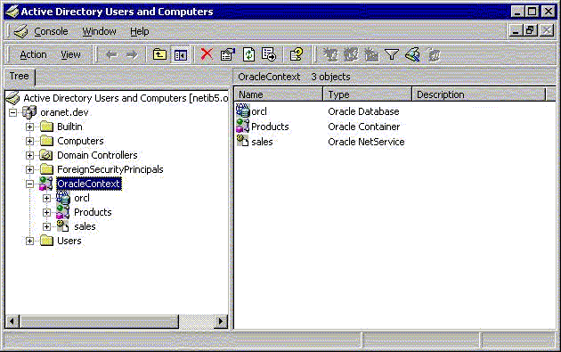

If Oracle Database and Oracle Net Services are installed and configured to access Active Directory, then Active Directory Users and Computers displays Oracle directory objects, as illustrated in Figure 12-1:
Figure 12-1 Oracle Directory Objects in Active Directory Users and Computers
Description of Figure 12-1 follows
Description of "Figure 12-1 Oracle Directory Objects in Active Directory Users and Computers"
Table 12-1 describes the Oracle directory objects appearing in Figure 12-1.
Table 12-1 Oracle Directory Objects
Object Description
oranet.dev
The domain in which you created your Oracle Context. This domain (also known as the administrative context) contains various Oracle entries to support directory naming. Oracle Net Configuration Assistant automatically discovers this information during Oracle Database integration with Active Directory.
OracleContext
The top-level Oracle entry in the Active Directory tree. It contains Oracle Database service and net service name object information. All Oracle software information is placed in this folder.
orcl
The Oracle Database service name used in this example.
Products
Folder for Oracle product information.
sales
The net service name object used in this example.
Users
Folder for the Oracle security groups. See "Access Control List Management for Oracle Directory Objects" for more information. Enterprise users and roles created with Oracle Enterprise Security Manager also appear in this folder.

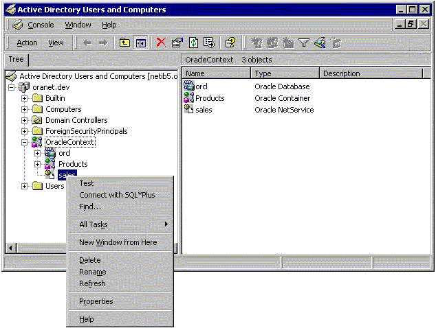

    All clients accessing an Oracle Database server through Active Directory require read access on all net service name objects in the Oracle Context and must be able to authenticate anonymously with Active Directory. Oracle Net Configuration Assistant automatically sets this up.
  2. Expand the domain in which your Oracle Context is located.
  3. Expand your Oracle Context.
  4. Right-click a database service or Oracle Net Service name object.
    A menu appears with several options. This section covers only the Test and Connect with SQL*Plus options.
    Description of adtest.gif follows

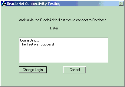

  5. If you want to test the database connection without actually connecting to it, then choose Test. A status message appears describing the status of your connection attempt.
    Description of adtstcon.gif follows
  6. If you want to test the database connection by actually connecting to it, then choose Connect with SQL*Plus. The Oracle SQL*Plus Logon dialog appears.

  7. Enter your username and password, then click OK. A status message appears describing the status of your connection attempt.

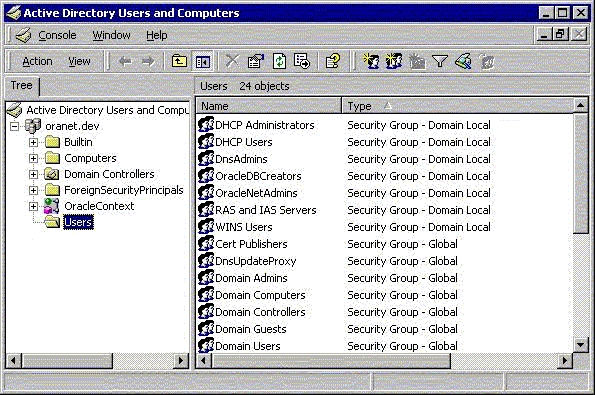

Security groups are automatically created when the Oracle Context is created in Active Directory. The user configuring access (and thus creating the Oracle Context) is automatically added to each group. The relevant groups are:
OracleDBCreators
The OracleDBCreators group is for the person registering the Oracle Database server. The domain administrator is automatically a member of this group. Users in this group can:
  • Create new Oracle Database objects in the Oracle Context.
  • Modify the Oracle Database objects that they create.
  • Read, but not modify, the membership for this group.
OracleNetAdmins
Users in the OracleNetAdmins group can:
  • Create, modify, and read Oracle Net Services objects and attributes.
  • Read the group membership of this group.

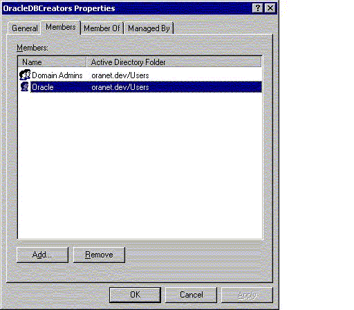

You can add or remove users in the security groups with Active Directory Users and Computers.
Use Active Directory Users and Computers to perform the procedures described in this section. Windows Explorer does not provide the necessary functionality.
To add or remove users:
  1. Choose Start > Programs > Administrative Tools > Active Directory Users and Computers.
  2. Choose Advanced Features from the View main menu.
    This enables you to view and edit information that is normally hidden.
  3. Expand the domain (administrative context) in which your Oracle Context is located.
  4. Expand Users.
    The security groups appear in the right window pane.
    Description of adsecgrp.gif follows
  5. Right-click the Oracle security group that you want to view or modify.
  6. Choose Properties.
  7. Choose the Members tab.
    The Properties dialog for the group you selected appears (in this example, OracleDBCreators).
    Description of admembrs.gif follows
  8. To add users, click Add.
    The Select Users, Contacts, Computers, or Groups dialog appears.
  9. Select the users or groups you want to add and click Add.
    Your selections appear in the Select Users, Contacts, Computers, or Groups dialog.
  10. To remove a user, select the user name from the Members list and click Remove.
  11. When you are finished adding and removing users, click OK.
