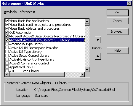

After the Oracle Database setup is completed, you can create the Visual Basic 6.0 project.
Start Visual Basic 6.0 and create a new project.
Make sure that the Microsoft ActiveX Data Objects 2.1 Library and Microsoft ActiveX Data Objects Recordset 2.1 Library are included as Project References.

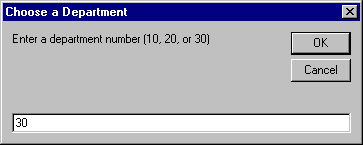

Run the project and check the results. For example, if you choose the Get Employee Records by Dept button, then you would see a dialog box requesting that you enter a department number.
After you have entered a department number and clicked OK, another dialog box displays employee names and numbers from that department.
