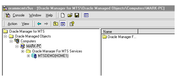

You must use Oracle Manager for MTS Services snap-in in the Microsoft Management Console Explorer to delete the OraMTS. Deleting the OraMTS in any other way (such as with the Delete button on the keyboard) causes data inconsistencies in the database. These inconsistencies require the database administrator to manually commit or terminate transactions that did not successfully complete or recover. Before deleting the OraMTS, ensure that all transactions are resolved by completing these steps:
Go to the computer from which to delete an OraMTS. You must modify an OraMTS before deleting it. The OraMTS can be running on this computer or on a remote computer that you can access from this computer.
From the Start menu, select Programs, then Oracle - HOME_NAME, then Application Development, then Oracle Manager for Microsoft Transaction Server.
The Microsoft Management Console appears.
Find the OraMTS to modify in the Explorer window.
Right-click the OraMTS icon to modify; MTSDEMO
in this example.
A menu with several options appears.
Choose Stop Service.
A message indicates that the OraMTS has stopped.
Click OK.

Find the OraMTS to delete in the Explorer window.
Right-click the OraMTS icon.
If you receive a message indicating that the OraMTS was successfully deleted, see "Deleting Roles and Privileges of an Inactive OraMTS User".
If OraMTS was not deleted successfully, see "Deleting Oracle Services for Microsoft Transaction Server Manually".
