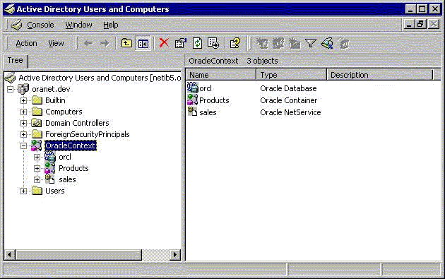

Figure 12-1 Oracle Directory Objects in Active Directory Users and Computers
Table 12-1 describes the Oracle directory objects appearing in Figure 12-1.
Table 12-1 Oracle Directory Objects
| Object | Description |
The domain in which you created your Oracle Context. This domain (also known as the administrative context) contains various Oracle entries to support directory naming. Oracle Net Configuration Assistant automatically discovers this information during Oracle Database integration with Active Directory. |
The top-level Oracle entry in the Active Directory tree. It contains Oracle Database service and net service name object information. All Oracle software information is placed in this folder. |
The Oracle Database service name used in this example. |
Folder for Oracle product information. |
The net service name object used in this example. |
Folder for the Oracle security groups. See "Access Control List Management for Oracle Directory Objects" for more information. Enterprise users and roles created with Oracle Enterprise Security Manager also appear in this folder. |

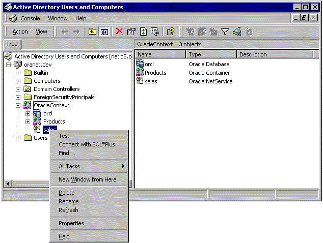

Right-click a database service or Oracle Net Service name object.
A menu appears with several options. This section covers only the Test and Connect with SQL*Plus options.

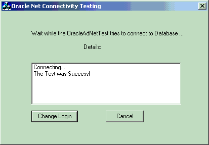

If you want to test the database connection without actually connecting to it, then choose Test. A status message appears describing the status of your connection attempt.
If you want to test the database connection by actually connecting to it, then choose Connect with SQL*Plus. The Oracle SQL*Plus Logon dialog appears.
Enter your username and password, then click OK. A status message appears describing the status of your connection attempt.

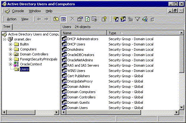

Choose Start > Programs > Administrative Tools > Active Directory Users and Computers.
Choose Advanced Features from the View main menu.
This enables you to view and edit information that is normally hidden.
Expand the domain (administrative context) in which your Oracle Context is located.
Expand Users.
The security groups appear in the right window pane.

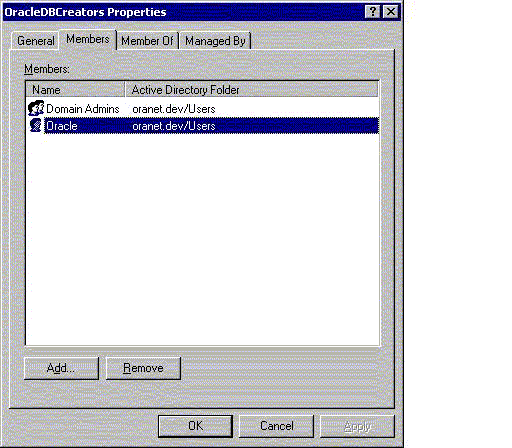

Right-click the Oracle security group that you want to view or modify.
Choose Properties.
Choose the Members tab.
The Properties dialog for the group you selected appears (in this example, OracleDBCreators).
To add users, click Add.
The Select Users, Contacts, Computers, or Groups dialog appears.
Select the users or groups you want to add and click Add.
Your selections appear in the Select Users, Contacts, Computers, or Groups dialog.
To remove a user, select the user name from the Members list and click Remove.
When you are finished adding and removing users, click OK.
