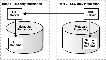

Alternatively, the Release 2 (9.0.2) Identity Management configuration can be distributed, in which Oracle Application Server Single Sign-On and Oracle Internet Directory each use a separate metadata repository. This is depicted in Figure 5-2.

Figure 5-2 Distributed Identity Management in Release 2 (9.0.2)

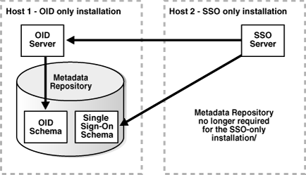

Figure 5-3 shows how the OracleAS Single Sign-On component of OracleAS Identity Management can be installed in a separate 10g (9.0.4) Oracle home from the Oracle Internet Directory, but share the same OracleAS Metadata Repository.

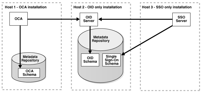

Figure 5-4 shows an extension of the previous example. It introduces a third host, which is used to host an Oracle Application Server Certificate Authority (OCA) installation. The OCA installation uses the same Oracle Internet Directory as OracleAS Single Sign-On, but it has its own OracleAS Metadata Repository to store the OCA schema.
Figure 5-3 Distributed Identity Management in 10g (9.0.4) - Example 1
Figure 5-4 Distributed Identity Management in 10g (9.0.4) - Example 2

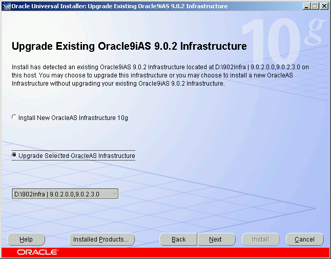

Upgrade Existing Infrastructure |
This screen appears when Oracle Universal Installer detects an existing Oracle Application Server installation of the same type as the one you selected on the Select Installation Type screen. Select the option to upgrade an existing OracleAS Infrastructure, and then select the Oracle home you want to upgrade from the drop-down list. (If there is only one Infrastructure of the selected time on the computer, then the drop-down list is inactive.) Figure 5-5 shows an example of the Upgrade Existing Infrastructure screen when you are upgrading from a Release 2 (9.0.2) OracleAS Infrastructure. |

A distributed OracleAS Identity Management configuration consists of multiple Oracle homes. One of the Oracle homes contains the Oracle Internet Directory.
In a Release 2 (9.0.2) distributed OracleAS Identity Management installation, the other Oracle home contains OracleAS Single Sign-On and its own OracleAS Metadata Repository (Figure 5-2).
This screen (Figure 5-5) appears when Oracle Universal Installer detects an existing Oracle Application Server installation of the same type as the one you selected on the Select Installation Type screen. Select the option to upgrade an existing OracleAS Infrastructure, and then select the Oracle home you want to upgrade from the drop-down list. (If there is only one Infrastructure of the selected time on the computer, then the drop-down list is inactive.) |

In a 10g (9.0.4) distributed OracleAS Identity Management installation, the other Oracle homes contain additional OracleAS Identity Management components, such as OracleAS Single Sign-On, Delegated Administration Services, Oracle Directory Integration and Provisioning, and OracleAS Certificate Authority.
To upgrade a 10g (9.0.4) distributed OracleAS Identity Management configuration (as shown in Figure 5-3), do the following:

After performing a distributed Identity Management upgrade (depicted in Figure 5-2 and Figure 5-3) from Oracle9iAS Release 2 (9.0.2) to Oracle Application Server 10g Release 2 (10.1.2), the OracleAS Single Sign-On schemas are relocated in the Oracle Internet Directory database. OracleAS Portal keeps a database link reference to the OracleAS Single Sign-On server password store schema ORASSO_PS. This link reference must be updated.
To re-register OracleAS Portal with the upgraded OracleAS Single Sign-On server from a middle tier whose version is 10g (10.1.2):
Change directory to the following location in the destination middle tier Oracle home:
DESTINATION_ORACLE_HOME\portal\conf
Run the following command:
ptlconfig -dad portal_DAD -sso
See Also: Oracle Application Server Portal Configuration Guide, for more information about theptlconfig tool
If the version of your middle-tier is lower than 10.1.2, you must use the Oracle Portal Configuration Assistant command line utility ptlasst to reregister OracleAS Portal with Oracle Single Sign-On. Refer to the appropriate version of the Oracle Application Server Portal Configuration Guide for instructions on how to use ptlasst.
After performing a distributed Identity Management upgrade (depicted in Figure 5-2 and Figure 5-3) from Oracle9iAS Release 2 (9.0.2) to Oracle Application Server 10g Release 2 (10.1.2), you may need to re-register mod_osso in order for an Oracle9iAS Release 2 (9.0.2) middle tier to operate with the upgraded OracleAS Single Sign-On server.
You will need to do this if the Oracle HTTP Server host and port information for mod_osso was changed. Before re-registering mod_osso, you must first set the value of the ColocatedDBCommonName attribute in the following configuration file to the global database name of the new OracleAS Single Sign-On server database shared with Oracle Internet Directory (for example, iasdb.host.mydomain).
SOURCE_ORACLE_HOME/config/ias.properties
