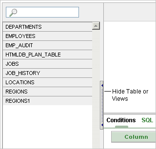

The Object Selection pane displays on the left side of the Query Builder page and lists tables, views, and materialized views within the current schema.
Topics in this section include:
Use the Object Selection pane to search for and view tables, views, and materialized views within the current schema.
To search or filter objects:
On the Database Home Page, click the SQL icon.
Click the Query Builder icon.
Query Builder appears.
In the search field at the top of the pane, enter a case insensitive query.
To view all tables or views within the currently selected schema, leave the search field blank.
You can hide the Object Selection pane by selecting the Hide Table or Views control. By hiding the Object Selection pane, you can increase the size of the Design and Result panes.
The Hide Table or Views control displays on the right side of the Object Selection pane. If the Object list appears, selecting this control hides it. Similarly, if the Object list is hidden, selecting this control causes the pane to reappear.

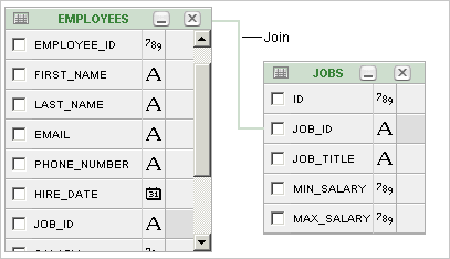

You can create relationships between objects by creating a join. A join identifies a relationship between two or more tables, views, or materialized views.
When you write a join query, you specify a condition that conveys a relationship between two objects. This condition is called a join condition. A join condition determines how the rows from one object will combine with the rows from another object.
Query Builder supports inner, outer, left, and right joins. An inner join (also called a simple join) returns the rows that satisfy the join condition. An outer join extends the result of a simple join. An outer join returns all rows that satisfy the join condition and returns some or all of those rows from one table for which no rows from the other satisfy the join condition.
See Also:
Oracle Database SQL Reference for information about join conditionsYou can create a join manually by selecting the Join column in the Design pane.
To join two objects manually:
From the Object Selection pane, select the objects you want to join.
The objects display in the Design pane.
Identify the columns you want to join.
You create a join by selecting the Join column adjacent to the column name. The Join column displays to the right of the datatype, beneath the Remove icon. When your cursor is in the appropriate position, the following help tip displays:
Click here to select column for join
Select the appropriate Join column for the first object.
When selected, the Join column displays as a dark gray. To deselect a Join column, simply select is again or press ESC.
Select the appropriate Join column for the second object.
Tip:
You can also join two objects by dragging and dropping. Select a column in the first table and then drag and drop it onto a column in another table.
When joined, a green line connects the two columns.
Select the columns to be included in your query. You can view the SQL statement resulting from the join by positioning the cursor over the green line.
Click Run to execute the query.
The Results pane displays the query results.

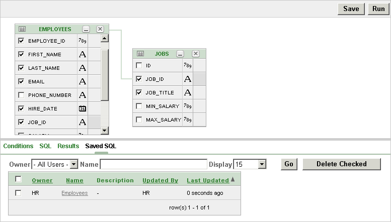

As you create new queries, you can save them by clicking the Save button in the Design pane. Once you save a query, you can access it later in the Saved SQL view.
To save a query:
Build a query:
Select objects from the Object Selection pane.
Add objects to the Design pane and select columns.
Execute the query.
Click Save.
Enter a name and description and click Save.
The saved query displays in the Saved SQL view.
Note that Query Builder does not support duplicate query names. If you open an existing query, keep the existing name, and save it again, Query Builder over-writes the existing query. If you change the name of an existing query and save it again,Query Builder saves the query again under the new name.
Once you save a query, you can access it in the Saved SQL view.
To edit a Saved SQL query:
Select the Saved SQL tab.
To filter the display, you can:
Make a selection from the Owner list and click Go.
Enter a search query in the Name field and click Go.
To edit a query, select the appropriate name.
The saved query appears. The selected objects display in the Design pane and the Conditions view appears.
