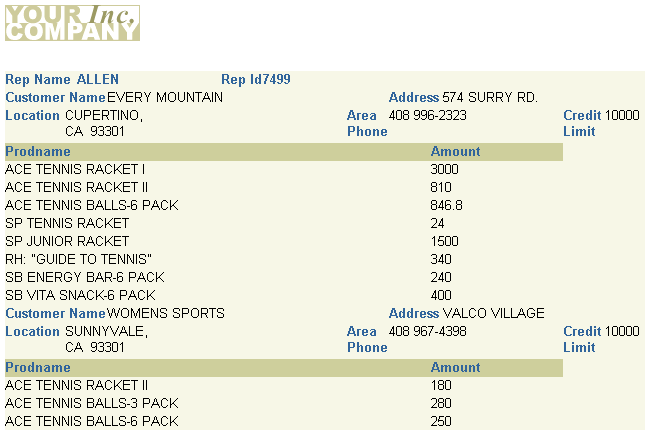

In this chapter, you will learn about reports that resets page numbers based on data shown. By following the steps in this chapter, you can generate the report output shown in Figure 19-1.
Figure 19-1 Pages renumbered by repeating frame report output
This example numbers pages using the format "Page X of Y". The first number (X) corresponds to the current page for each parent record (that is, each sales representative). This page number is reset to "1" for each sales representative, thus tracking the statistics of each representative separately.
The second number (Y) is the total pages required to display the customer information for each sales representative. This field is also reset with each new parent record.

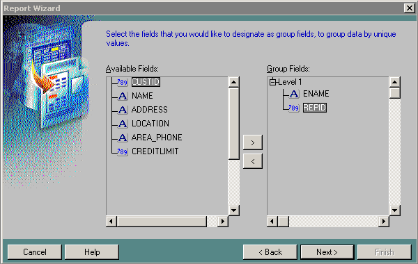

On the Groups page, click ENAME in the Available Fields list and click the right arrow (>) to move this field to the Group Fields list.
Move REPID to the Group Fields list, too, then click Next.
Figure 19-2 Selecting group fields in the Report Wizard

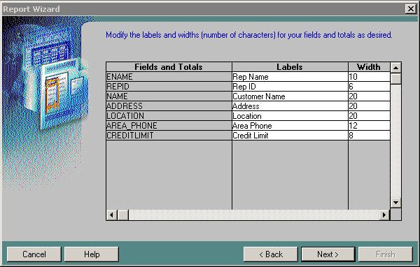

On the Labels page, change the labels and field widths as follows, then click Next:
| Fields | Labels | Width |
| ENAME | Rep Name
10
| REPID | Rep ID
6
| NAME | Customer Name
20
| ADDRESS | Address
20
| LOCATION | Location
20
| AREA_PHONE | Area Phone
12
| CREDITLIMIT | Credit Limit
8
Figure 19-3 Specifying labels and widths in the Report Wizard

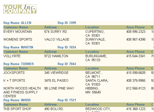

On the Template page, click Finish to display your report output in the Paper Design view.
Save the report as pagenum_your_initials.rdf.
In the Paper Design view, the data is grouped by the Sales Representative with customer data listed below each Sales Representative.
Figure 19-4 Report layout in the Paper Design view
All the data will display on one page and the individual sales transactions for each customer is not yet available. You will need an additional query in the Data Model to accomplish this.

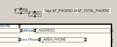

Next, you will reference these fields in a text box to display page numbers in the format "Page X of Y Pages."
To reference the page number fields:
In the Paper Layout view, click the Line Color tool in the tool palette.
In the color palette, click No Line.
Click the Text tool in the tool palette.
Position the cursor in the top margin where you would like the page number to appear, and click to create a boilerplate object.
In the new boilerplate object, type Page &F_PAGENO of &F_TOTAL_PAGENO.
Figure 19-7 Page number source and reference fields in top margin of report
In the report output, the current page number will appear where you reference the field F_PAGENO, while the total number of pages for each master will appear where you reference the field F_TOTAL_PAGENO. If you wish, you can resize the page number boilerplate text object to lengthen it to ensure that no values for F_TOTAL_PAGENO get truncated.
Save and run your report. Your final report output should look something like this:
Figure 19-8 Final pages renumbered by repeating frame report output
