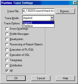

Enabling report tracing generates a text file that describes the series of steps completed during the execution of the report. Tracing can be set to capture all events or just specific types of events. For example, you can trace just the SQL execution or just the layout and formatting. The trace file provides abundant information, which is useful not only for performance tuning but also for debugging reports and identifying performance bottlenecks.
Generating a report trace file
To enable tracing, do one of the following:
In the Reports Builder user interface:
Choose Program>Tracing.
Select the Trace Mode.
Select appropriate Trace Options. The trace file now logs information for the entire Reports Builder session.
Figure 20-1 Reports Builder Runtime Trace Setting Dialog Box
For Reports Builder (rwbuilder) and Reports Runtime (rwrun), specify tracing options (described in Section 3.2.1.13, "trace") in the rwbuilder.conf configuration file, or on the command line using TRACEFILE, TRACEMODE, and TRACEOPTS.
Note: Command line tracing options override the options in therwbuilder.conf file.

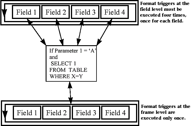

Format triggers should be placed at the highest level possible in the object/frame hierarchy so that the trigger fires at the lowest possible frequency. For example:
